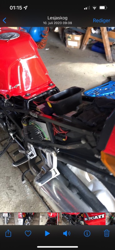

Not exact same regulator but had same problem, put mine under left rear sidcover close to the battery.

Thats a logical spot and my thinking is I will do the same. Where did you run the stator wires?

Sorry, it is years ago so i dont remember exactly but i belive it was along the frame rails.
Found a picture with the new placement of the regulator but dont remember how to post it on the board :roll:
Edit, found out how to attach pic
Image :mrgreen:
