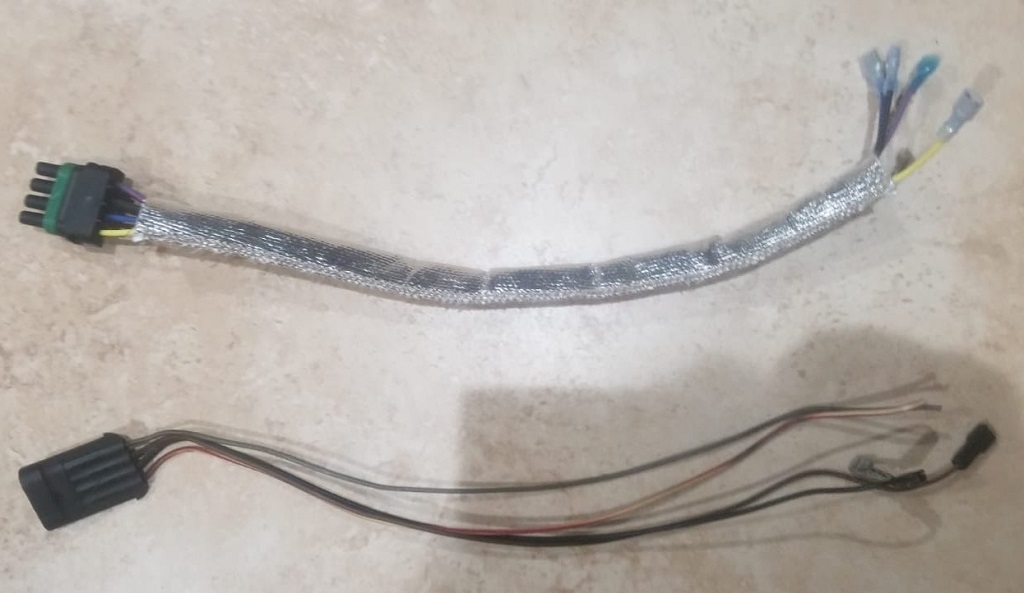

I built a new harness with these parts from eBay.
WhatsApp Image 2020-09-29 at 4.09.37 PM.jpeg (97.36 KiB) Viewed 8527 times
16 AWG GXL high temperature automotive wire in colors to match what is shown in the wiring diagram rather than what I found. So, Violet for +12V, Black for ground, Blue for fuel level sensor, Yellow for reserve fuel level.
One 4 Pin Delphi Weather Pack Sealed Connector Kit 14-18 AWG
Three 1/4" insulated male spade connectors (from my own supply)
One 4.8 mm insulated male connector (sold in pack of 20)
One insulated metallic heat shield sleeve 1/2" (sold as 3 ft strip)
I connected the other half of the Weather pack connector to the main harness. The final product worked well, but it did not solve the problem. Rechecking everything, one of the relays was not reliable I cleaned the contacts and it's good for now, although I need to replace the two FI relays.
