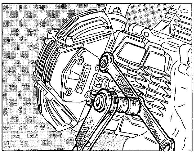

The attached diagram might help to give you a better understanding of how to measure the shims and once you have pushed down the closing rocker insert a 10mm allen key below to prevent it from returning. This willl make it much easier to remove (and replace) the half rings and and closer shim.

A normal ring spanner wouldn't fit on the cylinder head nuts. It needs to be a flat spanner with a thinner ring. Also to torque the bolts a special tool is needed. It's possible to make one if you modify (if I remember well) a 15mm ring spanner and weld a socket nut to it or you can get inexpensive ones on ebay. The ring to socket nut has to have a specified distance (which I can measure, I have one). If that is incorrect the torque will be, too. When applying torque the tool has to be held in 90° angle to the torque wrench. See picture.

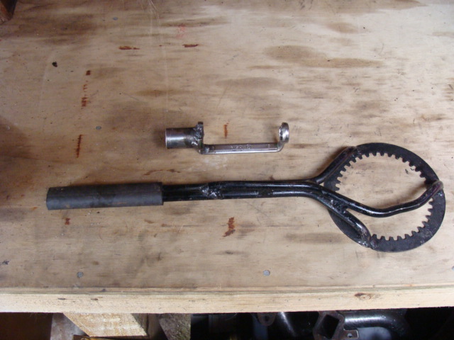

Hi there , one ( or two ) things Id like to add is that the closing shims clearance is near as dammit zero at 0.01mm ( less than 1/2 a thou ) and in practice this equates to ...............once you have stopped the closing rocker spring having any effect ( 10mm allen key if you like
) is that you should be just able to turn the valve by rotating the stem between thumb and fore finger . This is something you sorta grow into so until you get the hang of it do use feeler gauges. Front pot access is not easy , I just lie down on the ground.
Often the collets will come out in pieces and can look a bit " hammered " round the circumference and just replacing any damaged ones will go a long way to getting the clearance back to spec . The factory ones are crap and a far better option is to use MTB collets ( google em up ) they aint cheap but are good value in the long run . I have noticed that the harder you flog the motor the more attention the valves will require . I used to measure the clearances and then remove and individually bag each shim with its respective clearance and take them to the local Ducati mechanic who would then exchange them for ones that would give me the correct clearance , and charged me 10 bucks a piece. Openers can be ground a wee bit . Opener clearance will tend to close up and closers will go bigger so if you and set the clearance at the best end of the range gives you a bit more "wear " before having to reset them again.
Here is a pic of my cylinder head nut spanner , and clutch tool , cant find one of my closing spring tool thing.
