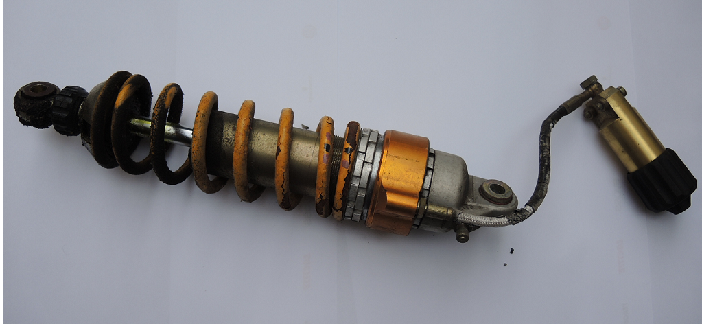

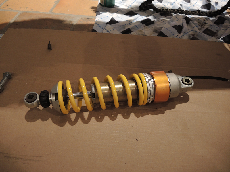

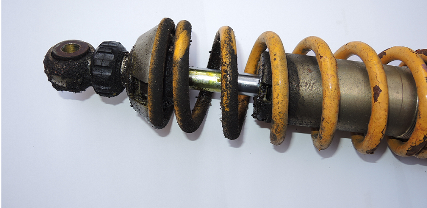

I have a 1986 750 Paso with an Öhlins rear shock absorber and had the same problem. I've had it overhauled and serviced by an approved Öhlins service center in Belgium. Cost me around EUR 200,-
Absolutely worth the money and the effort.
The paint job of the spring was done by a local paint jobber. If you decide to go for an overhaul and this repaint then ask them to add a flex additive to the paint so it won't crack as the spring gets stressed. Good luck.
Regards, Ronald
