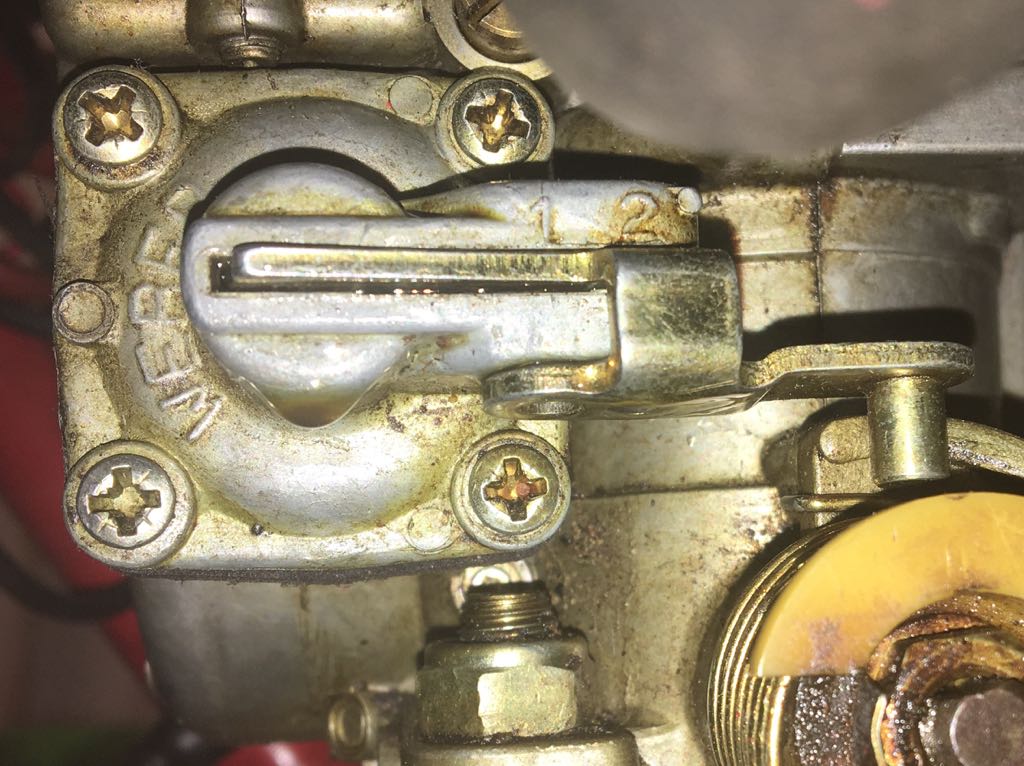

Hi,
What is this part of carb and how can I prevent it from leakage? When turning the gas handle this part moves and starts to drip a little gas over time...

That's the accelerator pump. There's a membrane behind the cover that may need to be replaced.

Got one from local bike part seller. Hopefully it is the right part :)

All Weber DCNF's use the same one

That fixed it! Great, once again thanks to you guys :)
This also fixed the rushing issue and bad idle running I had in my other post.
