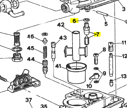

You mean the number 6 rubber?

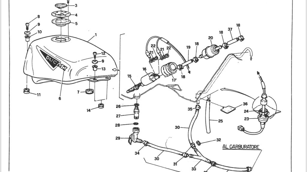

Re: 750 Sport run issue
as in your picture the return connection is the one on the outer side. It sounds ok.
If you open the carb do also verify that the floater actually still floats. If it isn't airtight anymore it can fill up with fuel, sink and leave the valve open.

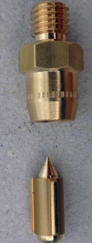

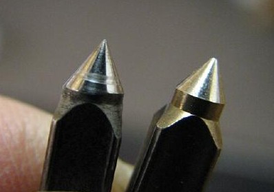

no I mean number 7 but I have to correct myself. Often valve needles have a rubber tip but the ones in the DCNF don't seem to. Still they can wear. On the bottom there's an example found on a website about Kawasakis. It's a worn vs a new jet. The marks can be minimal and only hard to see.

then you need to check all fuel connections are correct and also check the return is free, if the jet in the return line (#32) is full of dirt then your return is not working causing the pressure encrease in the system.
