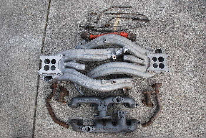

Posts: 2038
Re: weber manifold "what if ?"
yep , check out this Mopar cross ram manifold for dedication to the long intake runner :)
