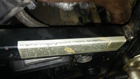

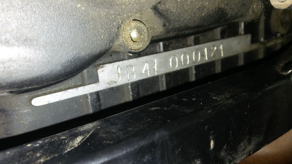

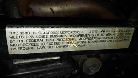

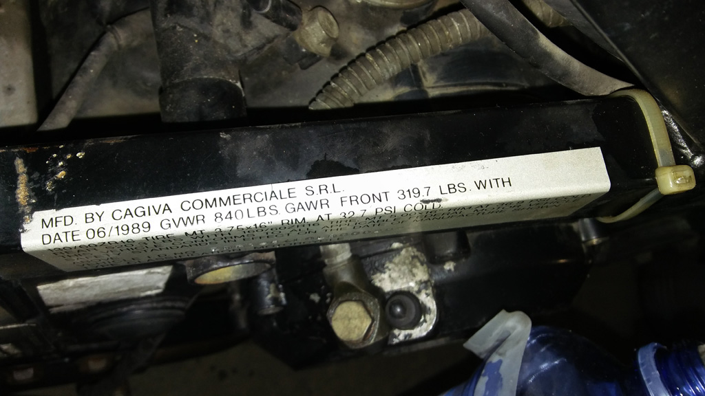

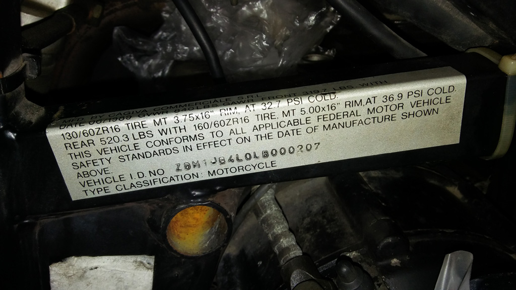

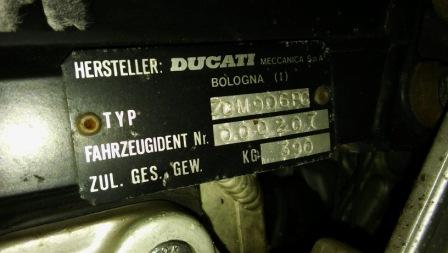

Hello, I see I'm not alone confused by VIN. I did not help with Ducati, and one of my companions found a single record for the motorbike that was made in 2.October 1989, June 1989 and according to the vin is a 1990 model.
The number on the engine makes no sense at all
I'm sorry, but it translates it for me google, so maybe it makes a little sense what i wrote :-D

Re: vin problem
Can't help with the number unfortunately. I find it interesting that is says Cagiva on the sticker and also that it is on the right side of the frame. Is't it usually on the left side?

Re: vin problem
On the right side there is a metal label with VIN and on the left side there is another sticker
