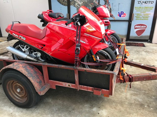

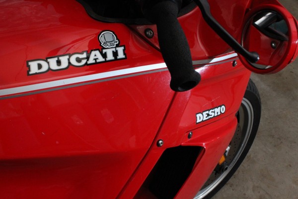

Hello all from the great state of TEXAS! Here are some pics of my recent purchase (about 4 weeks ago) from a craigslist add. I had 2 weeks earlier wrecked hard on my 04 Multistrada 1000 ds, and was looking to have something older to work on when I found this beauty!
- Day after I bought it, checking on parts
- 90 percent day after I bought it.jpg (96.58 KiB) Viewed 38532 times
- 750 close up at 90 percent.jpg (47.84 KiB) Viewed 38532 times
- Got it running yesterday! 1988 750 (non calif. model from what I gather), one of 55 shipped to US in 88
- good 750 pic 90 percent .jpg (72.68 KiB) Viewed 38532 times

I like the trailer
( and the bike
) , looks like a real Kiwi home made job ( that's a compliment
Welcome to the madhouse
