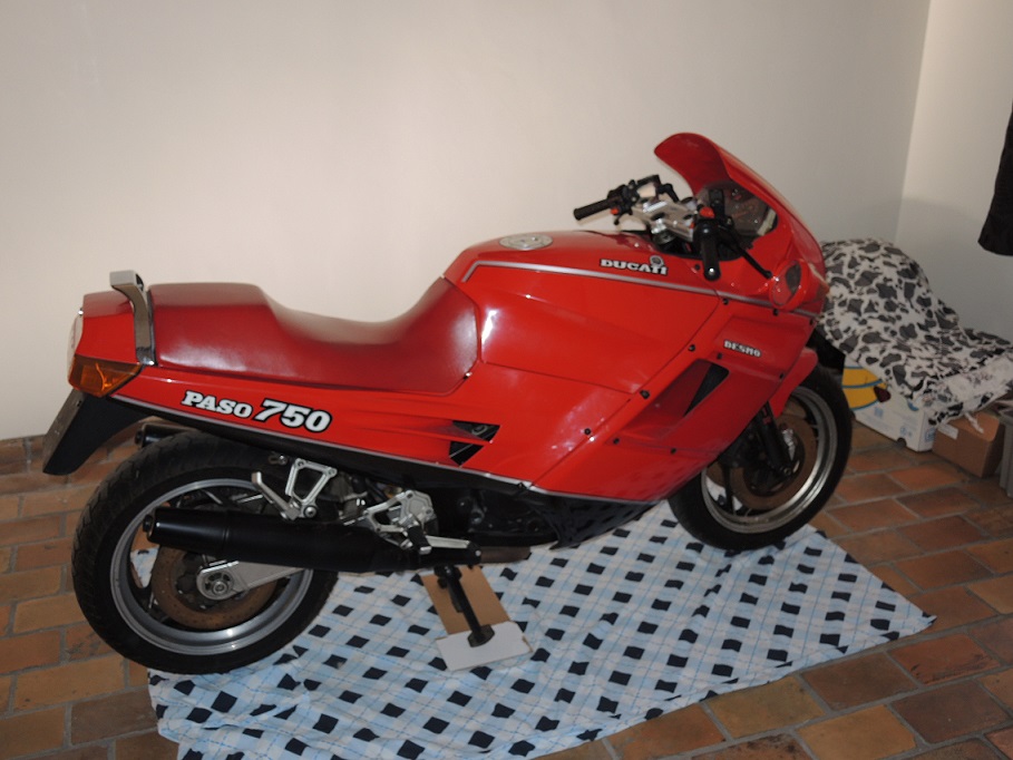

- DSCN1672 small .jpg (165.96 KiB) Viewed 15433 times

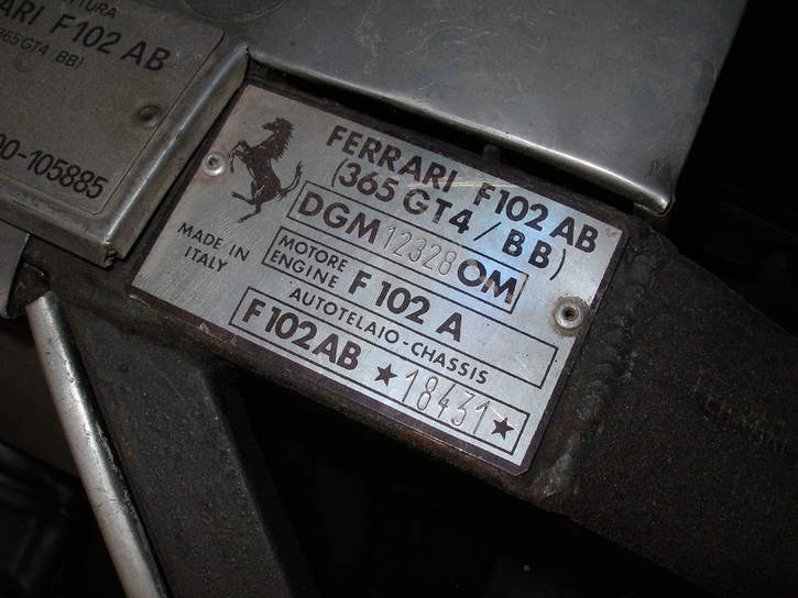

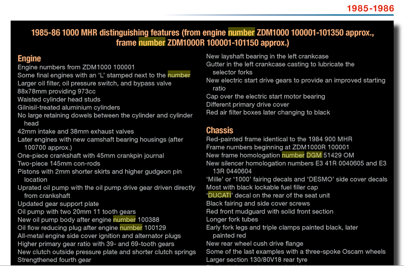

just examples for the DGMxxxxOM number on older models:
DGM52055OM is just a homologation certificate (which is the same on all Pasos that have that type of VIN) and a suffix to the frame number.
DGM = Direzione Generale della Motorizzazione (general department of motor vehicles/ type number)
OM = omologato dal Ministero dei Transporti e dell'Aviatione Civile (homologated by the department of civil transport and aviation)
xxyyyy is the frame serial number of which yyyy should be the actual production number of your frame.
ZDM750Pxxxxxx should be the only relevant number.
Maybe Frank.61 can help. He`s in Belgium, too and has the same kind of VIN.
- Unbenannt-1.jpg (161.24 KiB) Viewed 15423 times
- Unbenannt-2.jpg (267.4 KiB) Viewed 15423 times
Re: Bureaucracy strikes, not once but twice (or even 3 times
or on a car
- attachment.jpg (47.45 KiB) Viewed 15423 times

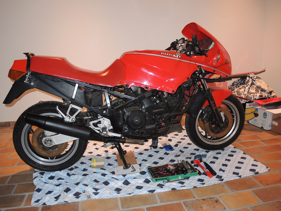

Hi Frank,
I received the license plate today. So that went quite fast
@mvric, I guess there's two with the same number then . . .
- DSCN1708 small.png (1.21 MiB) Viewed 15280 times
- DSCN1706 - small.png (1.21 MiB) Viewed 15280 times
