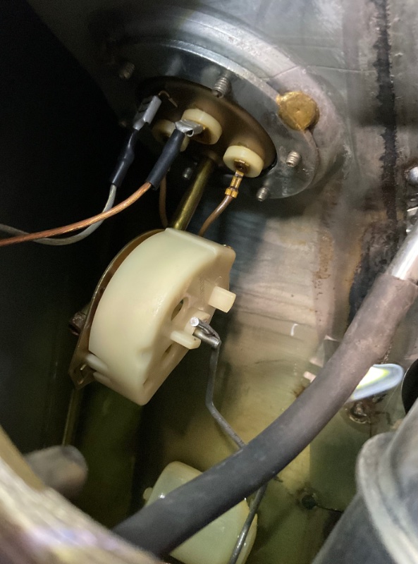

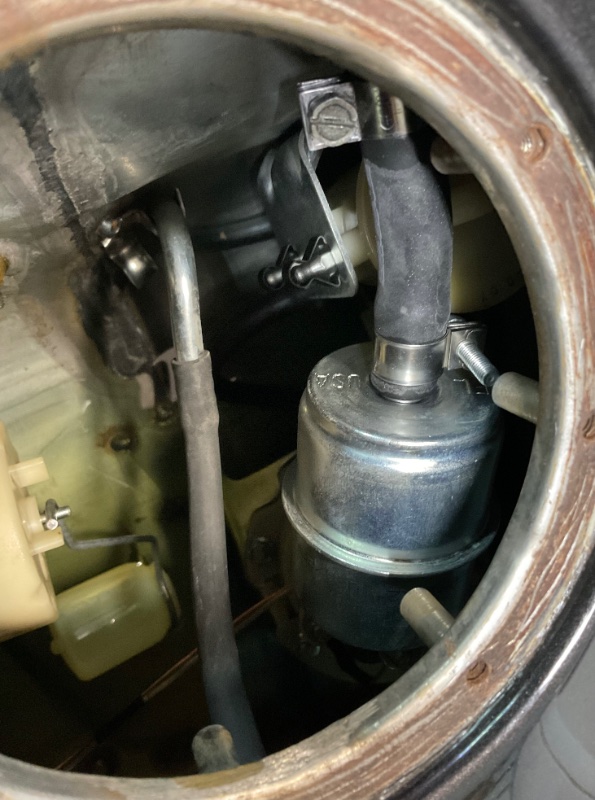

I recently used nickta’s very useful notes to change my 907ie fuel filter. Here a couple of additions and pictures others may find useful.
When reaching in thru the tank opening, I used my right hand, then tilted my torso way, way forward. This straightens out your wrist and lets your fingers have better dexterity. I did this with the tank on the floor for what it’s worth.
Pics of the wires to disconnect, and of the filter. I loosened the upper clamp 1st, then wiggled/slid the tube and filter off the stub to be able to lift everything out.
