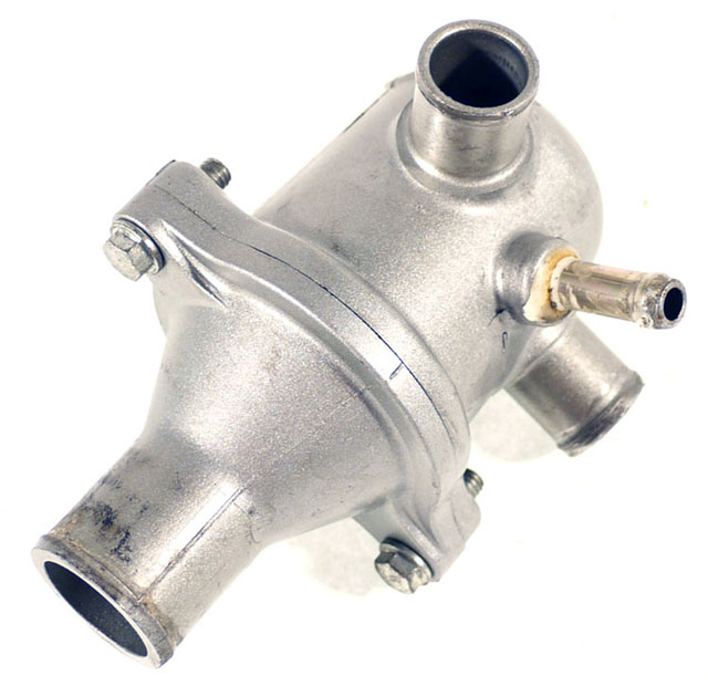

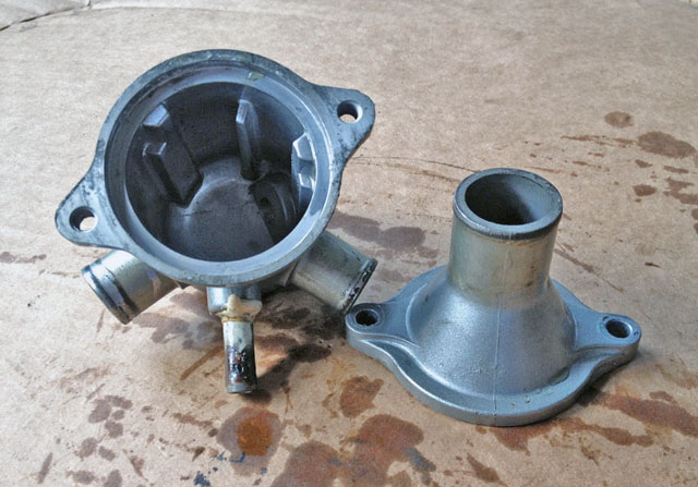

I don`t know if the hoses sizes are the same but did you see the one of the Hyosung GT 650 ?
Its problem of course is that hose nipple in the middle but seeing that the thermostat housing can be disassembled one could heat up the housing and pull the tube out (or cut it off) and if the housing was thick enough, tap the hole and insert a short screw with some thread sealant.
(That thread that can be seen inside the housing on the last picture is for a temperatur sensor)

just got a reply from a seller of a Hyosung thermostat on ebay. The larger hose connection is 26,6mm outer diameter (21mm inner) and the two others are 19mm (14mm inner).
