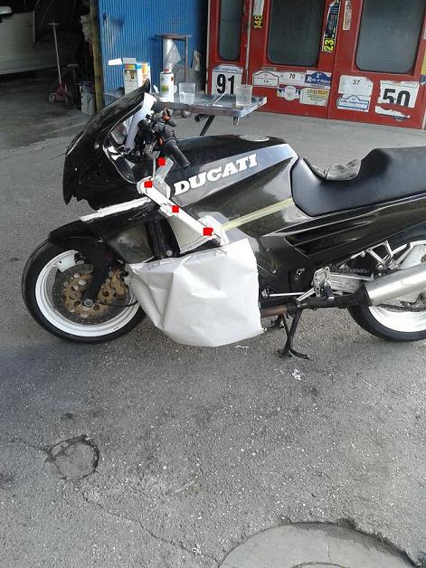

now i work to rebuilt the side fairings,and have a questions.
there are only 3 6mm and one 8 mm screws in each side connect fairing at fuel tank?(i paint it in red)
- forgotten.JPG (88.16 KiB) Viewed 21600 times
Re: new member
and 4 6mm underneath connecting the 2 side fairings

Re: new member
ok,i have this.and there is a connection under dash with 2 8mm screw.
i find and buy this piece on web.
another question:how the underseat fairings are connected on fuel tank? i have 2 big hole on fuel tank and 2 6mm screw with a litle rubber cylinder on fairings.
i think there are some pushin connections but see nothing on spare parts catalog.
or there are only screw from underseat to side fairings?
Re: new member
early bikes had rubber inserts and pins on the side panels. Later bikes left out the rubber inserts and only had square pegs All had 2 6mm holding the side panels to the rear of the side fairings
