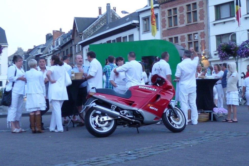

On road in Belgian Ardennes
- on road in Belgian Ardennes
