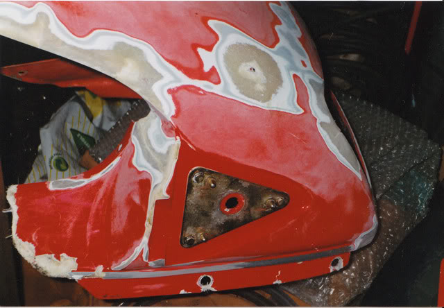

I fixed my side and front fairing (P750) and it`s still fine after 13 years.
