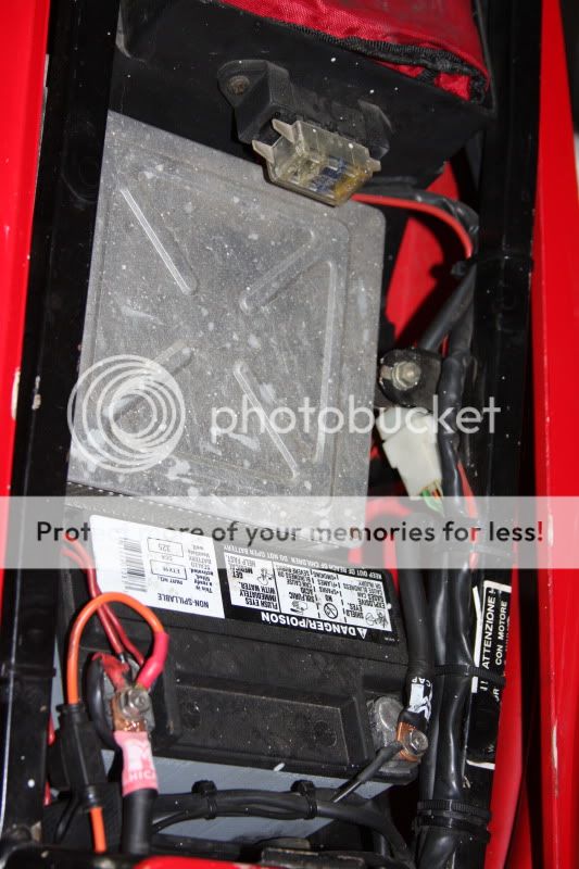

can anyone post a photo of their set ups please!

Probably pose more questions than answers,but anyway here you are. J

jayh wrote:Probably pose more questions than answers,but anyway here you are. J
what the hell,while I'm in picture upload mode.
Very different to mine!

Again an earth wire this side of the reg???

THANKS!!!! for all the photos-a joy just looking well cared for bikes! looks at first i might be missing the earth wire for something? is it the coils mine has one already where they are situated. like the upgrade makes for same place.Also each with a different regulator none same as ihad originally, 2nd rr51 what to do?
thanks again-what is that earth???

Ok Dave ,The black wire on my reg goes through the connector and turns into the green black wire going into the lower connector on the relay that is directly above it ,its a bit hard to see but the top wire into the relay is visible as a bluey/greeny colour,and the lower connector has two wires (both green black going into it,(one of these is connected back to the reg,I can't be bothered tracing the other one at the moment). J.
