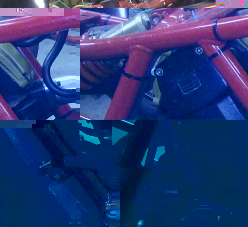

Hi,
I bought newer plastic case Ducati breather and have turned it to smaller diameter. http://cgi.ebay.com/ebaymotors/DUCATI-O ... 1c1e3fbf2a
So it now fit to replase the original hose connector in crankcase. It's connected to original bottle.
- vent.jpeg (174.72 KiB) Viewed 4698 times
