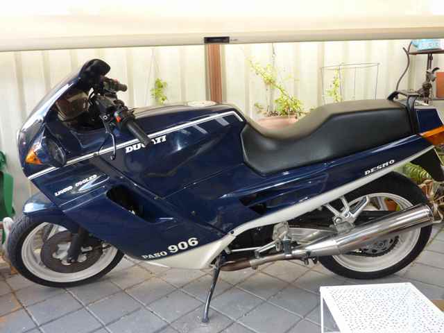

Hi all, my name is jeff and i hail from Adelaide Australia. have recently purchased this bike and am loving it.
I have workshop manual but no owners manual so am looking forward to gaining some knowledge on this bike.
Basics like checking oils and coolants ect.
cheers all for now
jeff
Mods include, Staintune exhaust, twin dellorto's with malossi manifolds. Ohlins shock, twin pull tommaseli throttle and the heads have been flowed.

nice bike.
You`ll find lots of info in the 906 and P750 FAQs and the manuals here:

I`m wondering about the Ohlins shock. If it is an aftermarket or from an early P750. If the later it may be a bit soft as the 906 is heavier. But that may be a good thing as Duc shocks used to be rather hard.

Hi P750, not sure about the shock as it was on the bike allready. I believe the original owner may have replaced it. The bike rides well and does not seem to harsh or sloppy. This will be the first sports oriented bike i have owned so am not to experienced on this type of bike. My previous bikes have all been Enduro/ road trail bikes with some smaller bikes, CB and LTD being my only road bikes. This bike was part of a will which was left to my brothers wife and they did not know what they were going to do with it, so I bought it because I had sold the CB some months back and something told me to buy it. Got it for a good price and the bike has been very well looked after its whole life. I was considering an XTZ 1200. (multistrada to dear
but this bike sounds magnificent and is lovely to ride so i will hang onto it and ride it often and hopefully I can grow to fully appreciate and enjoy this bike as you guys all do.

Welcome to the forum by the way mate - nice looking example!
I'd be interested to see how the remote preload adjustor is mounted on your bike by the way - I had the devils own time getting it to mount cleanly on the 906 frame......but then I think there is three or four versions of the various mounting brackets between 906/750/907 and MZ/Ohlins!

However, compliments. Beautiful bike, same colour of my first beloved 906
