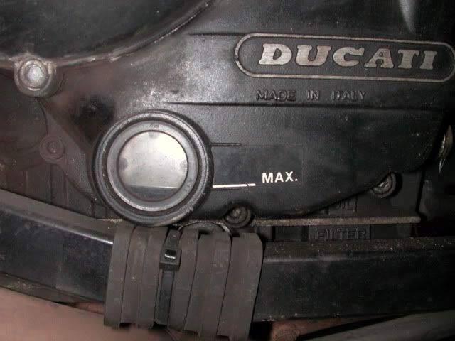

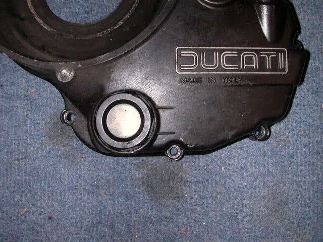

Every other Duc I've had has two lines next to the sight glass for the min and max oil level. Like PHOTO 1. But my 906 Paso (and others apparently) has a little sticker that fits perfectly between these two lines that shows the max level as at the lower of the two lines cast on the side case. Like PHOTO 2.

Probably like everyone else with a 906, I keep the level between the two lines cast on the side case and ignore the sticker.

Same problemo here,
and my cover looks like your photo 2.

Don't have the documentation to prove it but my guess would be they are both max levels. One cold and one hot.

That makes sense I think - although I still wonder why they went to the trouble of making a new sticker for that. First water cooled model I suppose.
It's a bit redundant having a max hot level though isn't it ? what do you do if when you fire it up the hot level is above the sticker line :)
I wonder if these stickers/decals are on the 907's as well?
I suppose I'll continue filling to the mid way between the cast lines on the side case and ignoring the sticker as always - anyone else do different?

I like that one G, but I think you will find when you fill it to the upper level on the center stand and then put it on the side stand the oil will be below the window completely. Wanna know how I know that ? :wacko: :wacko: :wacko: by the way,oil level should not be checked when the bike is on either stand :thumbup:
This is a fairly common practice industry wide

Just went out to look at mine,got a new twist. No sticker and 3 ribs cast into the cover more like photo 2(907ie,906 is at home). I'll post a pic later when and if I get home today :fart: :fart: :fart:

Higgy - I wasn't aware of this hot/cold thing (being a young-un). Thanks! I like the three line, no sticker twist......
