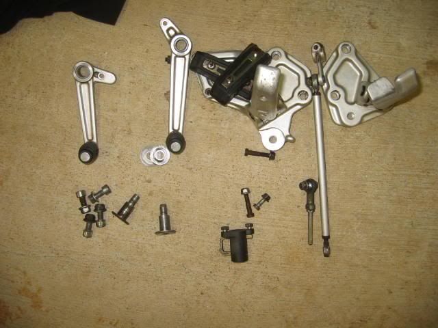

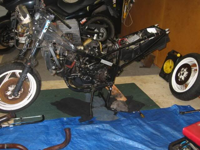

Here are some images as the Tear down starts.
What I am finding is lots of surface rust, dirt and grime gallore..
So every piece is carefully removed, Degreased, scrubbed and soaked in WD-40 if needed.
Bagging and tagging all bolts and small parts. Will go back later and make a list of new bolts needed Etc.

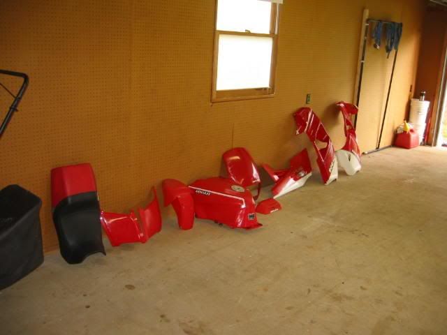

All the panels were degreased on the inside. Scrubbed down with Paint Thinner and 0000 Steel Wool.
Minor damages will need some attention.
Parts removal cleaning area (inside)
Lettn em soak.
Gonna paint em black.

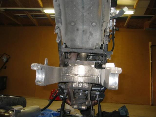

Naked rear end.

gumbotz , your paso looks a bit like mine at the moment, body work all off. One thing that I found very helpful is some sort of bench / table to get the bike up off the floor a couple of feet , makes life easier ( I made mine out of a piece of our fence )

The fun continues. Slowly tearing her down. Very DIRTY, lots of cleaning and scrubbing.

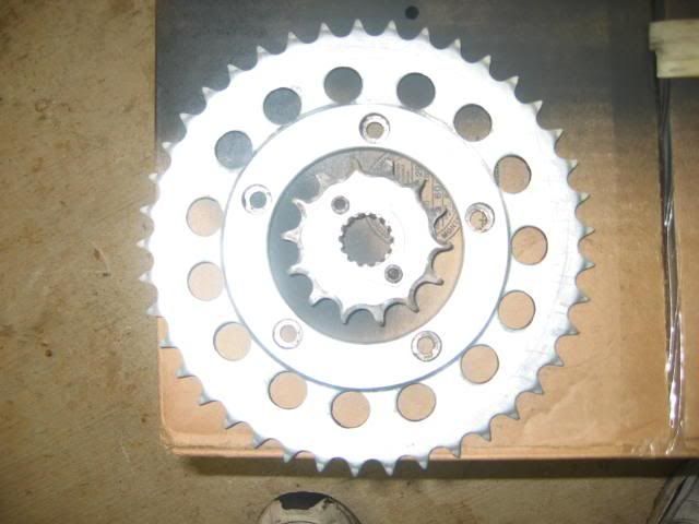

Sprockets got cleaned. Yes will need replacing.
Has Chain damages..

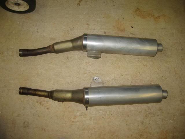

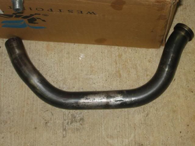

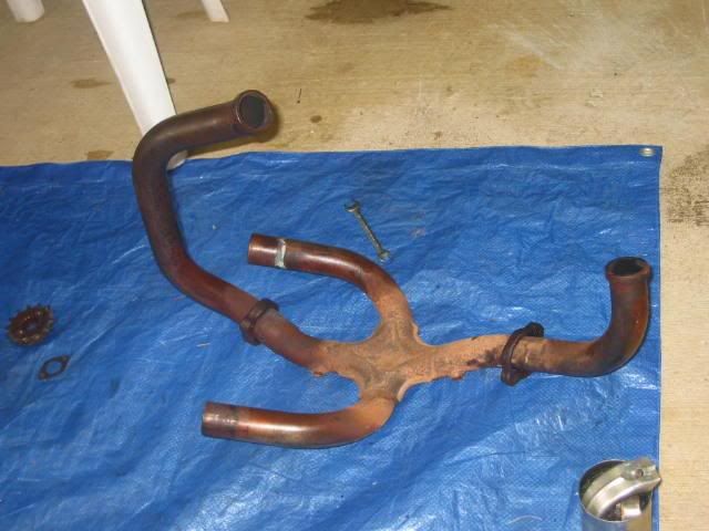

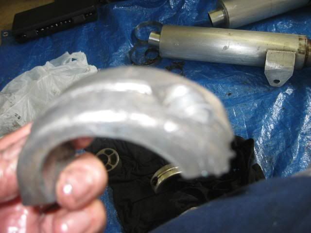

Next the exhaust. I thought this may be a Bitch due to the rust, but came off rather easily.

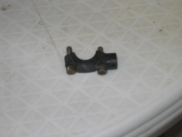

I cant remember what this was from.???? ( I normally bag and tag everything.)
I want to paint the exhaust cans BLACK, need to research what will work and
replace the clamps with BLACK ones if possible.

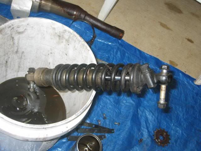

Rear shock needs to be replaced.
Using lots of WD-40, Carb cleaner and RAGS !!!!!

gumbotz wrote:Rear shock needs to be replaced.
Why do you want replace it?
Rebuild it with its overhauling kit.
Ciao :thumbup: :thumbup: :thumbup: :thumbup:
ducinthebay
Re: 1990 906 Paso (Rescued from a Friend)
Post by ducinthebay »
Your mystery part is a clamp for the brake or clutch master cylinder that has an added boss for a mirror. Not from the original bike, but used on Monsters and other bikes with mirrors attached to the bars. The previous owner may have replaced one of the master cylinders and found one from a Monster.
Your sprockets don't look too worn, but if they have lots of miles on them, and the chain is also shot, replace the entire set.
I agree with the WD40 comment. For a job like this, I usually spray everything with WD40, then follow with a spray of Simple Green a couple of hours later and hose it all down. Gets a huge amount of crud and crust out of the way before you even start. If you haven't discovered it yet, buy WD40 by the gallon can (~$15) and buy their pump sprayer. Lots cheaper than aerosol cans, and much more control in application.

Thanks I figured out what it was when I decided to organize some parts a bit..
Been buying WD-40 by the Gallon $12, and Spray bottle. Does save allot of time and $$.
Will try Simple Green as a Degreaser. Getting tired of scrubbing :wacko:
The exhaust cleaned up farely well. Will Heat paint it in the spring when it warms up.

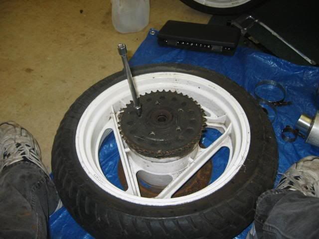

Figured on replacing both sprokets since the chain is toast. It's so RUSTY I wouldn't even attempt
a cleaning.

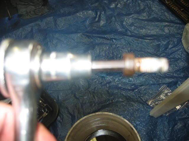

Had 1 stripped bolt on the rear disc. A 5.5mm Hex hammered in worked really well to remove it.
Didn't think of that. Great idea. Thanks
check out the teeth of the front sprocket, the ones in 12 and 5 o`clock position :mrgreen:
