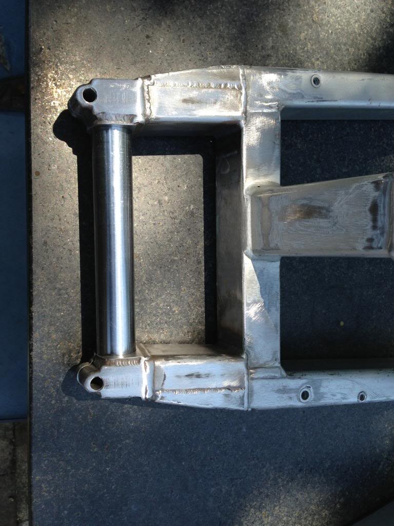

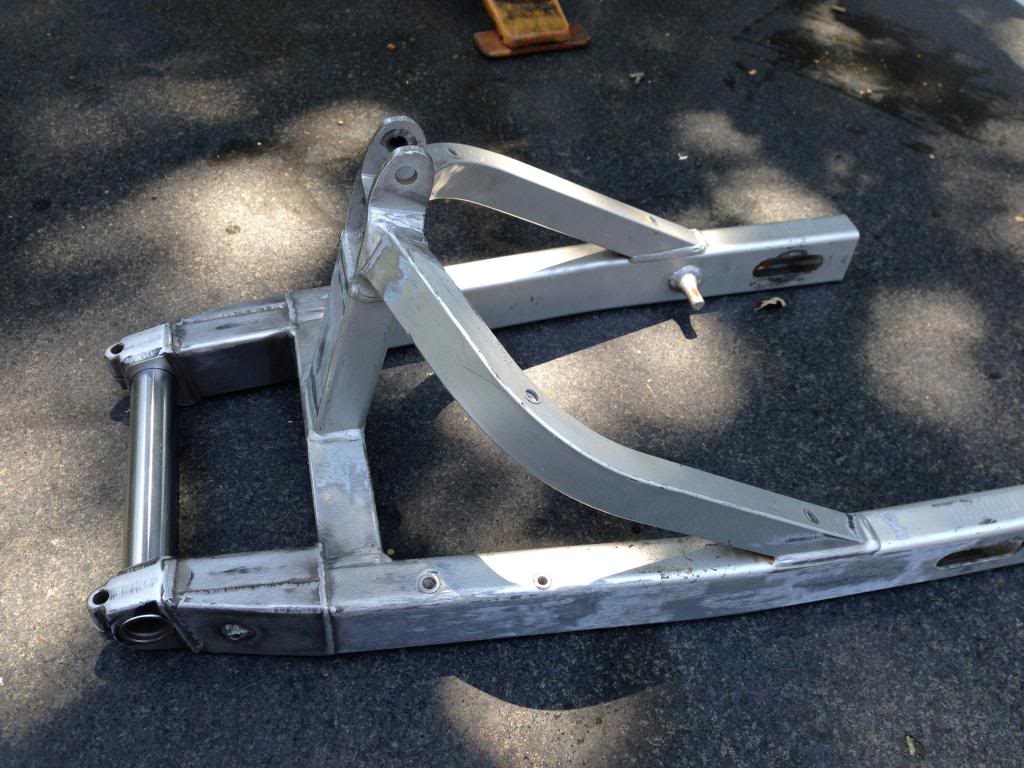

After much ado, I now have a swingarm hanging on my motor.
The stock swing arm was long since gone.

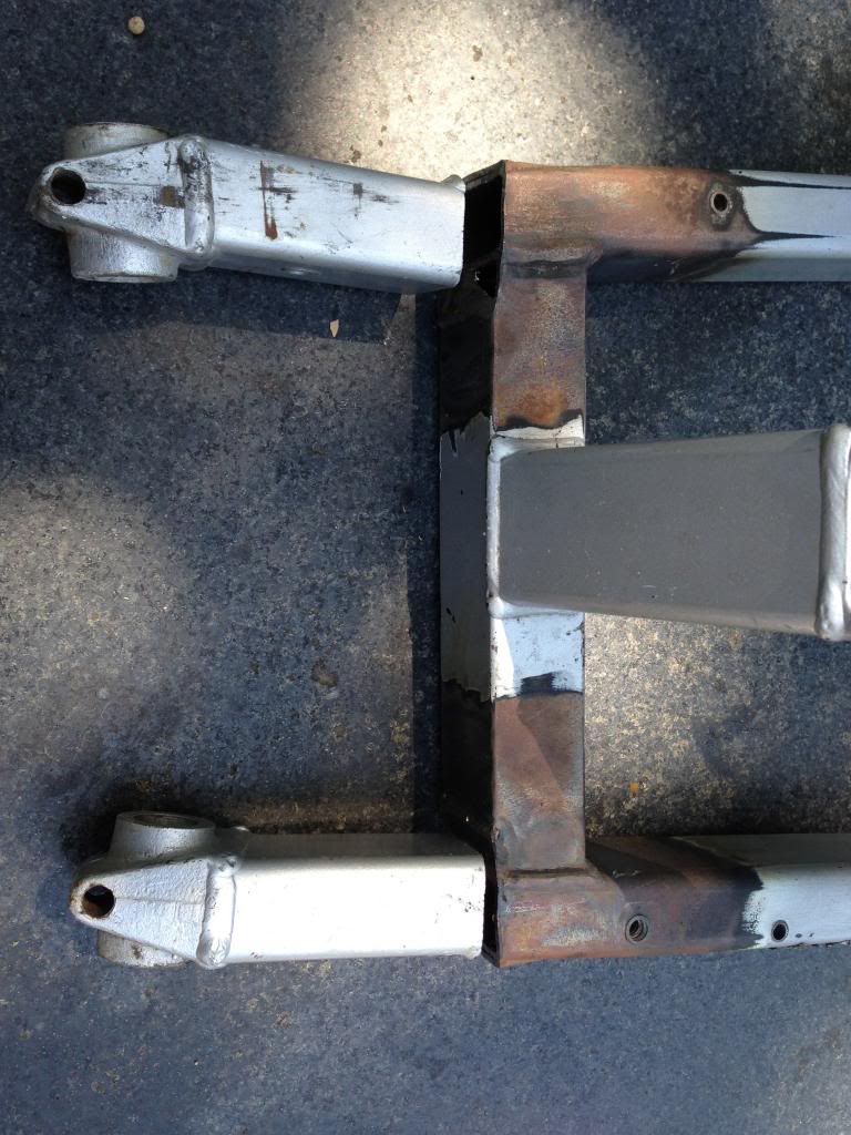

The swingarm on it was a steel one from a 90's 750 SS, modified to fit the 28mm pivot pin. But the swingarm was trashed by sprocket bolts that had backed out and destroyed the inside of the swing arm. The adjusters no longer slid in the tubes. After some discussion with a friend that welds, we opted for the simplest solution.
Cut off the forward arms off the modified swing arm.
Then weld them onto the donor swing arm (Steel SS swingarms are cheap)
and you have something that works once again.
Now, to fit in a wire spoke wheel into the swingarm from a Sport Classic. 17mm axle and 25mm bearings. Stay tuned. I have a plan.

Yeah, the forward arms were modified by the previous owner, and it was the shortest distance to getting a swingarm on it.
The F1 steel swing arm fit the bike, was too narrow for the Sport Classic rear wheel, by about 45mm. So I went with the steel swingarm for now. I'm still on the market for supermoto rear wheel to fit the uber cool F1 swing arm. But I have a swingarm and rear wheel now, so I'm not in a hurry to spend more money.
Posts: 5572
Re: Project - Nudo Nuovo
nice job & welding, the complete front part looks quite different now. :thumbup: How did your friend secure that the complete alignment was perfect ? I can`t really imagine how that is done.
ducinthebay
Post by ducinthebay »
He cut the forward sections off with the pivot pin clamped in place. He aligned the axle and pivot pin to be in the same plane, then welded it up. I need to confirm if the hash marks for the chain adjuster are in the correct position. Of course, what ever offset there was before, I have again, and no telling what that was, or is now. While the swingarm is a simple fork, there are many dimensions that you need to consider. I'm not confident that this thing is perfectly square, but close enough for rock and roll. I will spend some time getting the chainline perfect, and will use a chain adjuster tool that centers in the axle and the pivot pin, and measures both sides.
