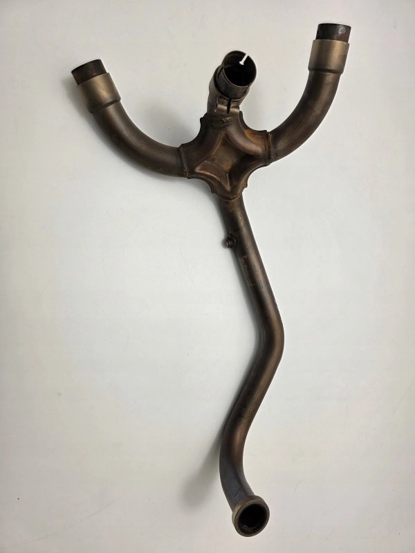

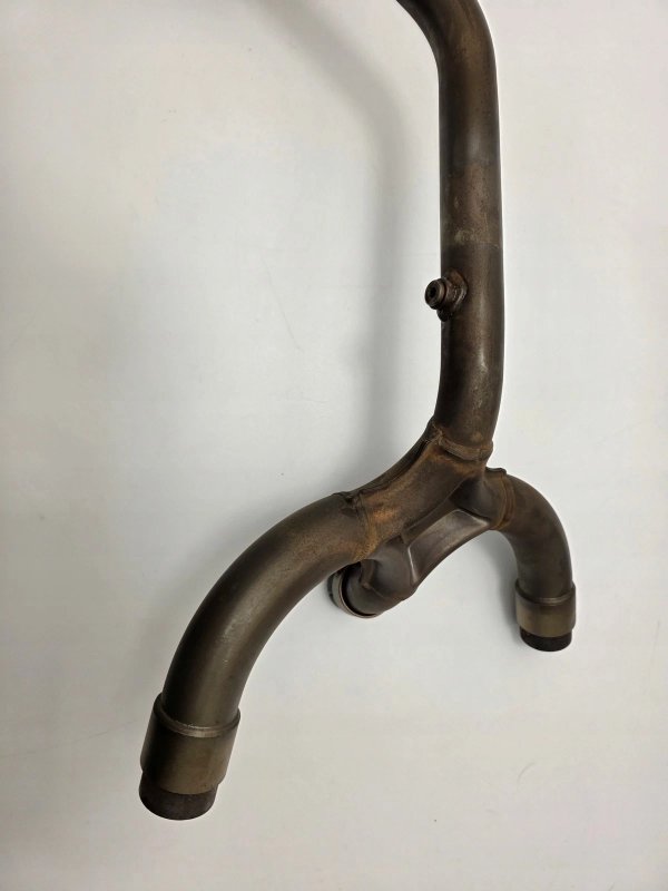

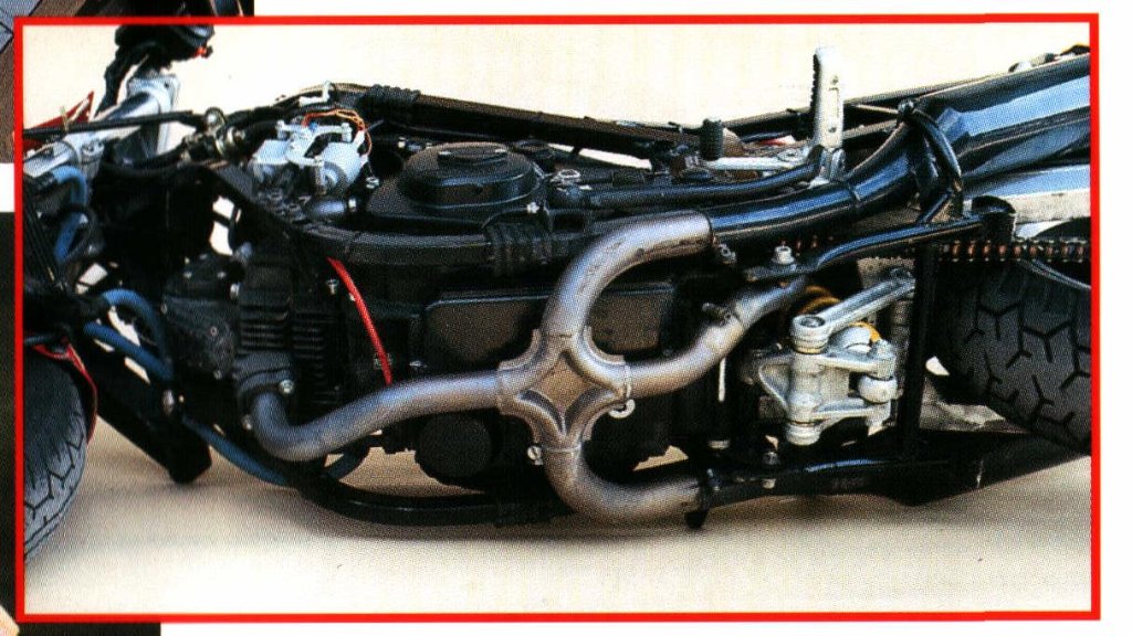

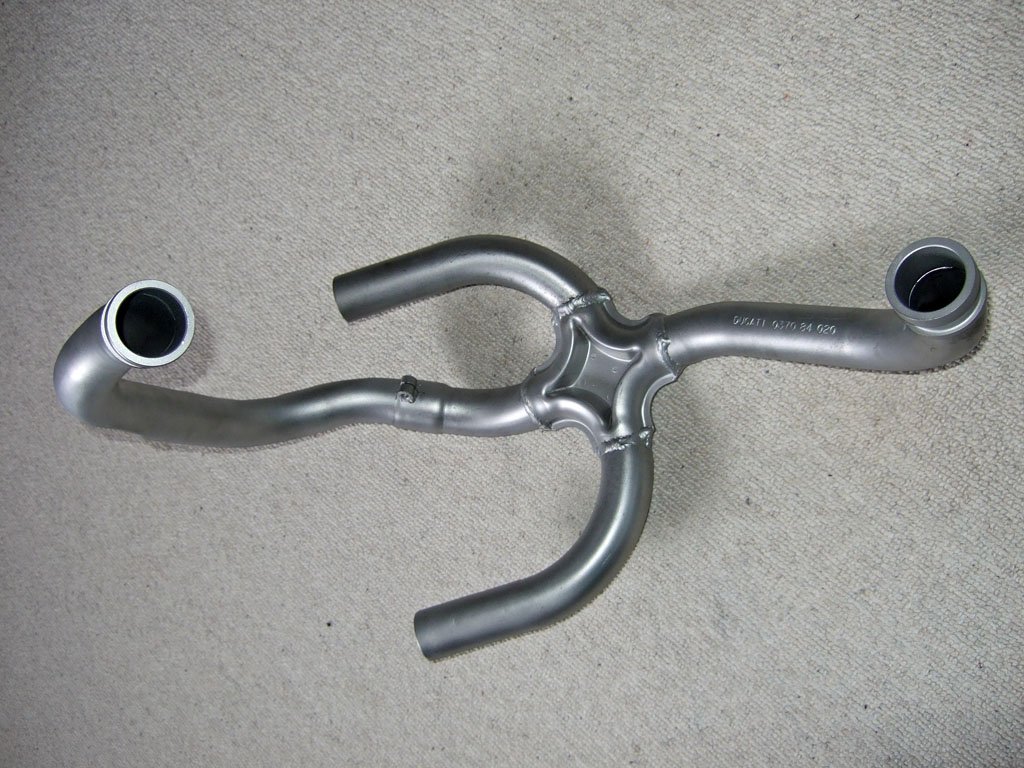

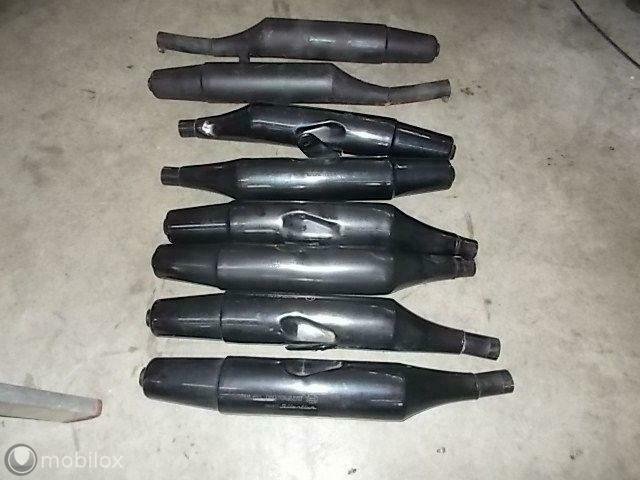

Hi,
no, they don't- It's not about the diameter but the overall shape. Below some pictures.
The first two show a SS header, which is similar to the one of the Sport. Towards the silencers it spreads outwards. The connection to the rear cylinder header tube angles steep upwards
The reason is the swingarm and shock setup.
In the 3rd pic with the silencers, the very rear ones are Paso, the others are Sport
The Paso header tubes run parallel below the frame rails and the silencers are longer and offset outwards.
Sport silencers angle inwards, therefore won't work on a Paso header.
Hi,
