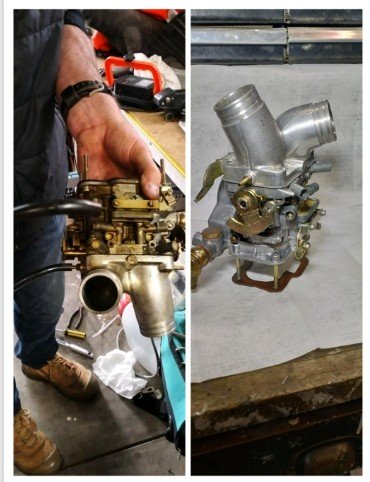

Bit of a diiference between straight off the bike to the ultrasonic cleaned version! New service kit and float installed ready to go back on the bike.
Niow, I've made a real rookie error...I didnt photo everthing and as its been weeks since the carb was removed I forget how the fuel lines went. I think the Y has the 2 branchs facing towards the front of the bike both connect to the tank, single goes to carb?
2X green translucent pipes. 1 goes onto the tank and vents to air, there is another on on the tank and I dont know where it goes (RHS)
The carb had one black pipe running from LHS to "computer" module at rear and the fuel line...anything else? Ahhh, for photos :-(

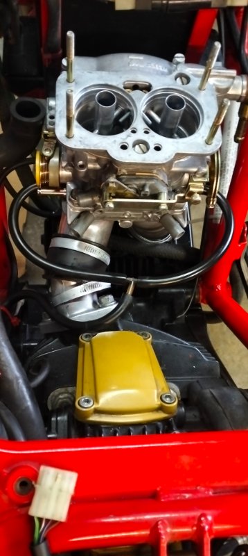

How's this look. I wasn't going to post this

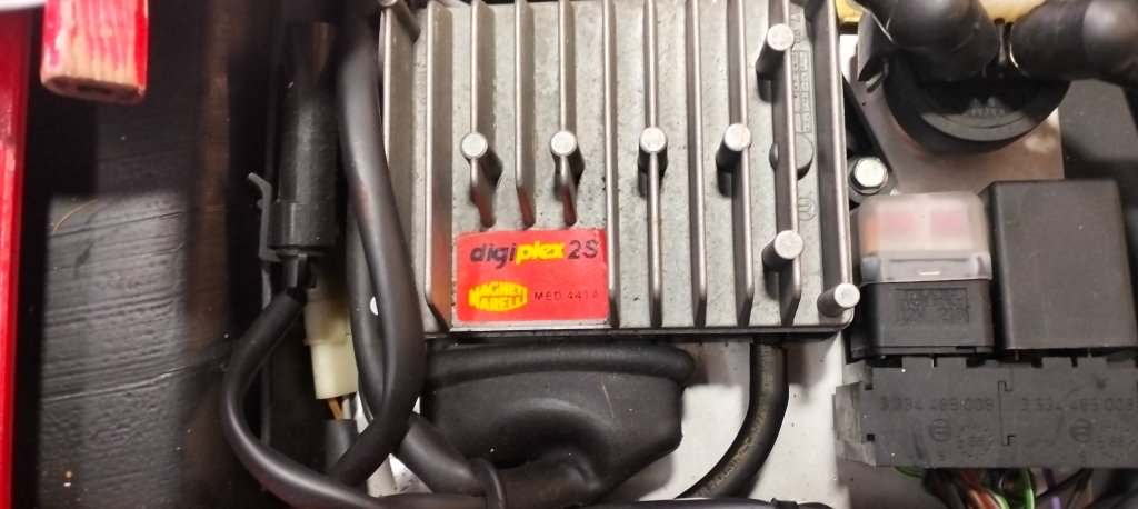

...but the T piece for the carbs vacuum line was amongst other bits and pieces and id forgotten all about it. Without your reply Mc tool I would have _ucked up royal. Thanks. Photos! I'll never forget to take photos again! 2 piece on each side of carb onto a pipe that runs back to the magnificent digiplex 2S by magnet marelli

The whole thing looks good

So off each side of the carb, into the T and then down the LHS of the bike into the box of tricks at the back. Bottom RH corner, that's the pipe connection
