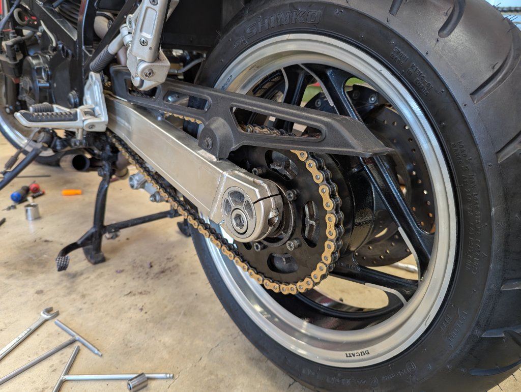

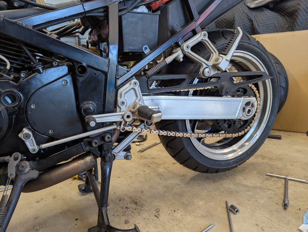

Life happens so I had some time away from this. Just threw a new chain and 40t rear sprocket on. Haven't set the tension yet but at least got it on.
