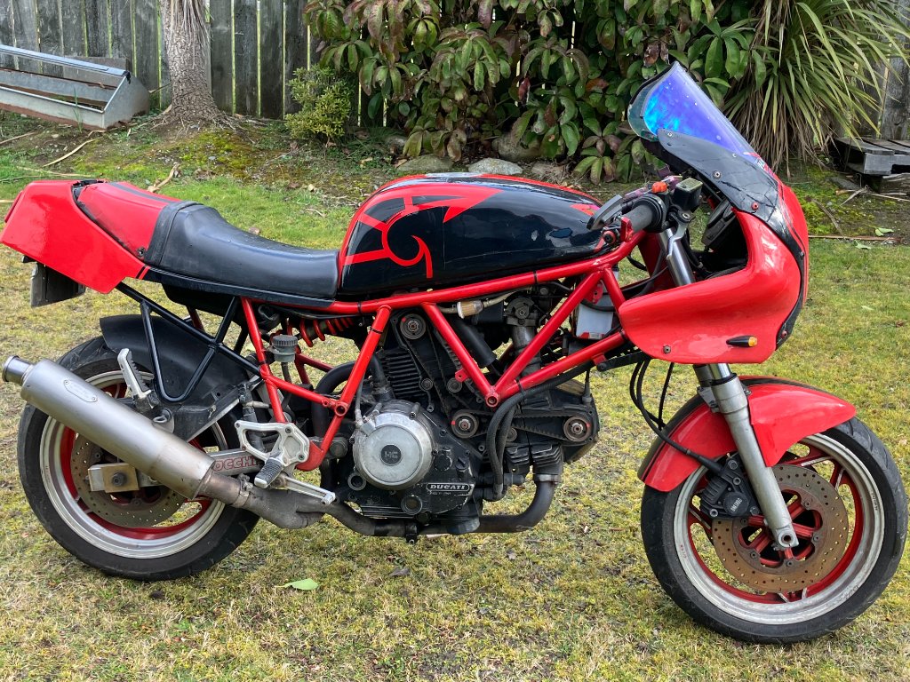

So I got the bike cheapish with 48,000km on the clock, dead rego and highly 'modified' appearance with the lower fairings missing due to a prevoius crash. I was looking for a pre '89 bike to turn into a classic racer. So thats the plan..

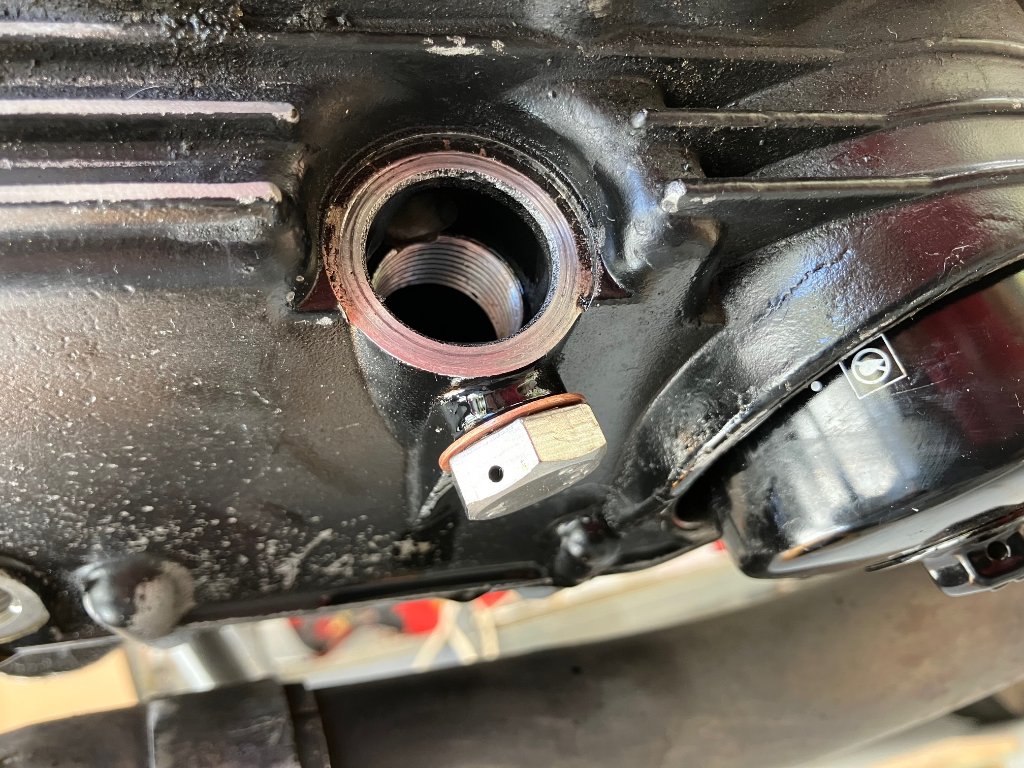

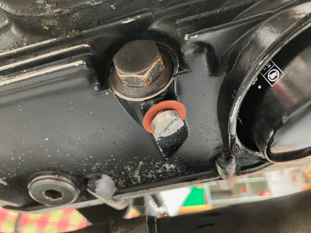

It had an oil leak on the LH case cover so I took it off and fit a gasket. At the same time I did an oil and filter change. Kinda weird having that extra little drain plug underneath the gauze filter housing?? My bike has an aluminium sloted head plug in there that is really tight on the thread. Is this standard? I'm going to need something I can drill like a hex head to get lock off wire through it.

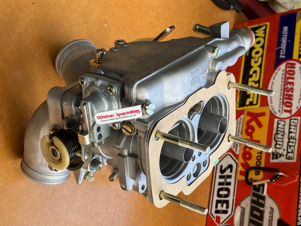

I've decided to stick with the original carb for now even though I know its not the best set up apparently. I sent it away to a Weber specialist outfit and they did a real good job cleaning it up and checking everything over. They found lots wrong (butchered!) with it so at least I know it is stock spec now. Looks like new now!

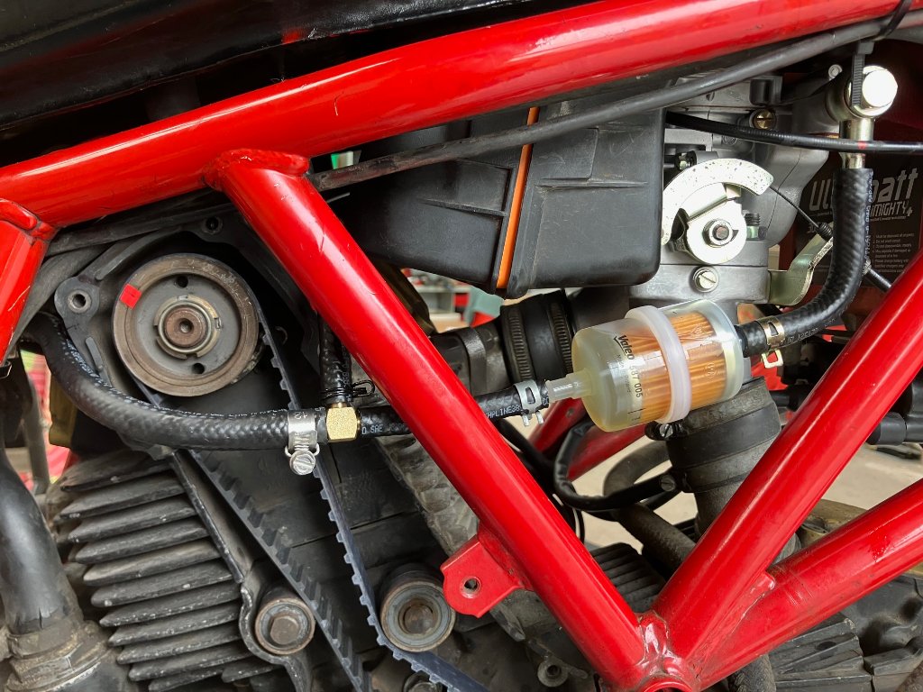

During the process of fitting a new fuel tap and inline filter I discovered there was no return line to the tank. I found it a bit fiddly trying to fit all this up near the tank with frame rails and the rear timing belt cover in the way so I have lowered everything down.

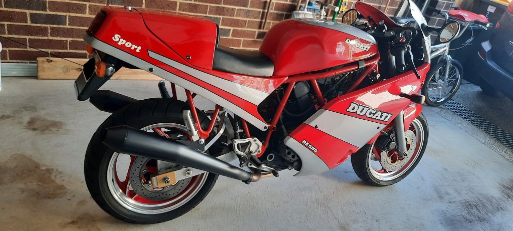

I've had mine for over 10 years now and in most part it's been fairly reliable and great to ride. I had a Weber float failure last year which resulted in flooding, unable to idle and oil contamination. Seeing the Weber uses a pressurised fuel feed, your needle valve and float must be in perfect working order along with a good quality fuel line and clamps.

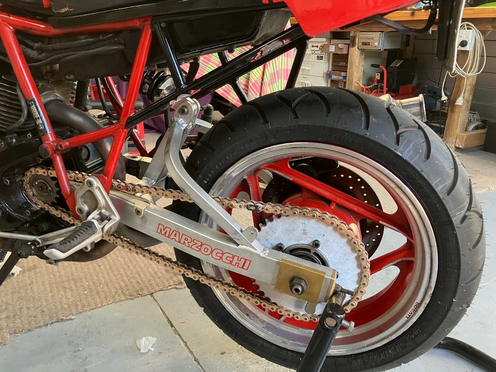

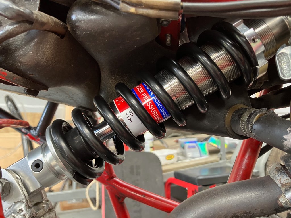

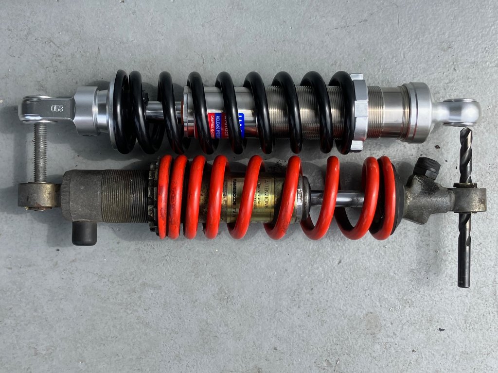

I started at the rear of the bike by removing the rear swing arm to get two cracks welded up and when I put that back in I fit a new Hagon shock. Unfortunately the Hagon shock is 5mm shorter than the OEM one despite being listed as the correct model for this bike. This has done nothing for my race geometry (opposite of what I want) so I've pushed the forks 10mm through the triple clamps to compensate. Not ideal as I'm losing ground clearance here!

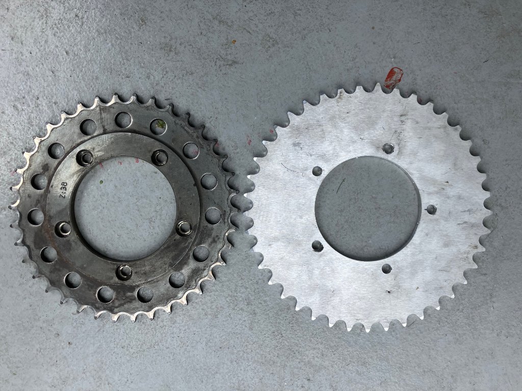

I wanted to lower the gearing but I couldnt find alternative size sprockets here in NZ so I bought a 41 tooth 520 pitch aluminum blank and lathed the center to suit the sprocket carrier and drilled the bolt holes to match. Weighs nearly a third of the OEM steel sprockets weight. Fitted new chain and front sprocket as well. You will notice in the second photo that I also cut off the pillion peg mount. Can re-weld it back on in the future if need be.
While I had the rear wheel out I fit a new Shinko tyre and I gave the rear brake a clean up and fit new pads. I did not refit the rear wheel hugger.

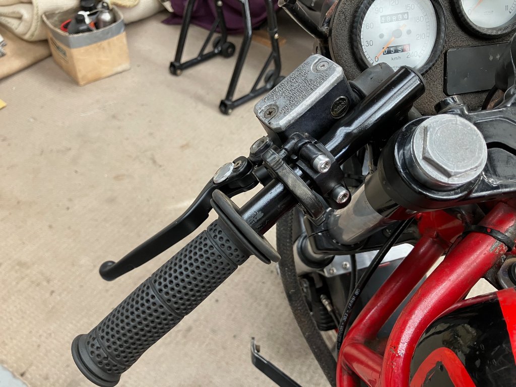

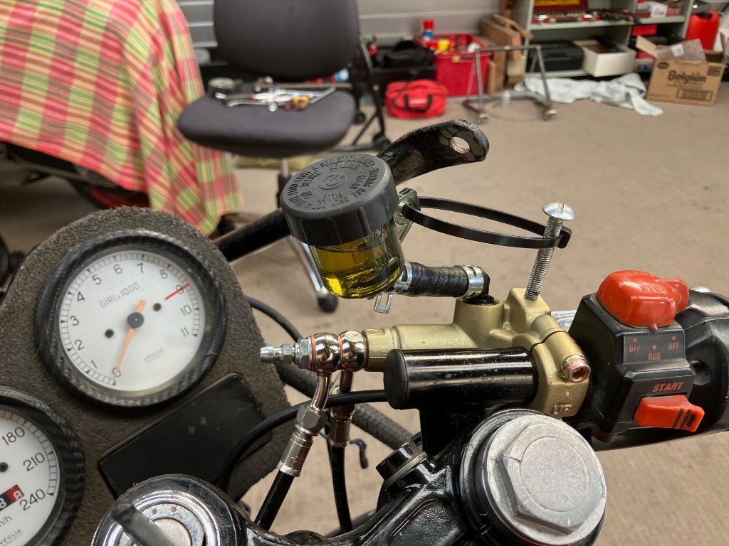

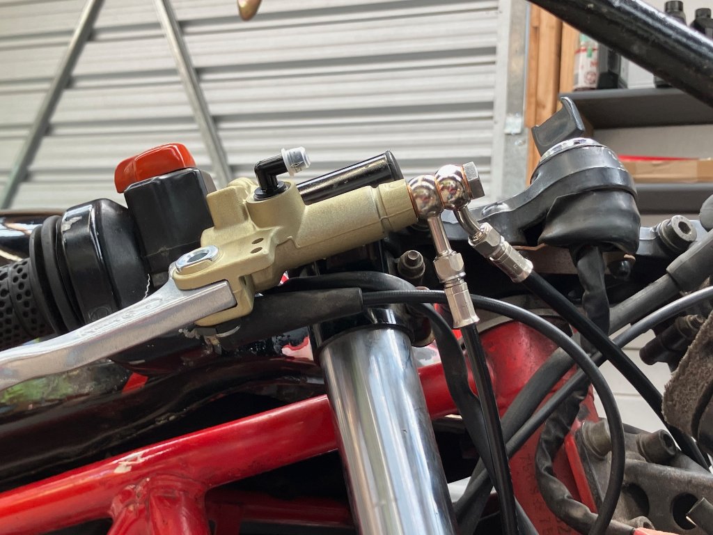

Big upgrade here, I fit a new Brembo master cylinder and got braided lines made to suit. It looks like I got my hose lengths correct luckily. I pulled the calipers apart for a deep clean and new seals. The ceramic pistons were in really good shape. I ordered a double banjo bolt with bleed nipple attached (second pic) as I have found from experience this makes bleeding up a whole lot easier. The lever travel is only 1/2" and very firm. I fit Newfren sintered pads as well. I hadn't used this brand before but they are Italian so kind of in keeping and they appear to work well. I'm real happy with the brakes on a road test but the track will be the acid test. You will see from the photos I need to make a mount bracket for the aftermarket reservoir!

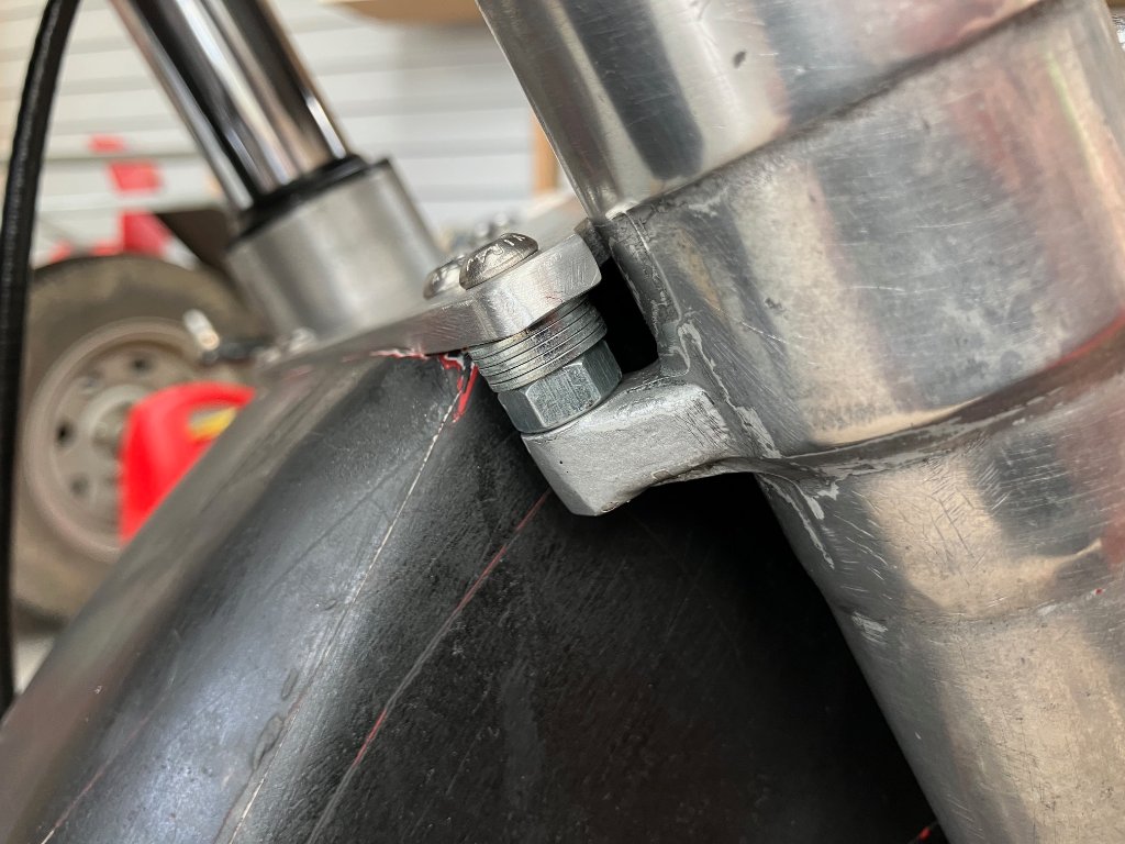

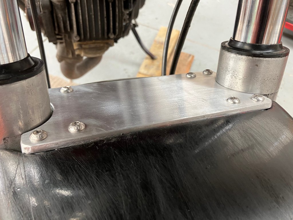

The previous owner had lost the original fork brace so I made a new one out of 6mm thick aluminum plate. Note my temporary spacers/packers underneath it to allow for the 70 profile front tyre. At the same time I removed the forks for fresh oil and seals.

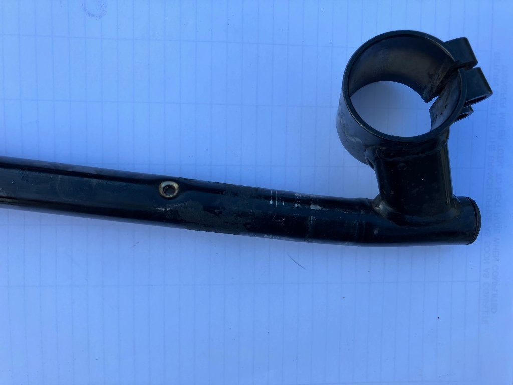

The LH clip on was bent so I straightened that, gave it a paint job and removed the LH switch block at the same time. I also fit a span adjustable clutch lever.

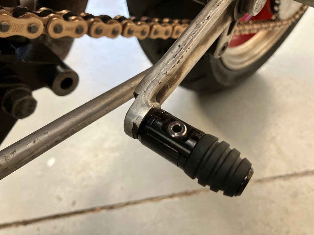

I had a spare Woodcraft folding tip for a gear lever floating around my race supplies box so that got fitted. Theres some slop in the linkages I need to address at some stage too.

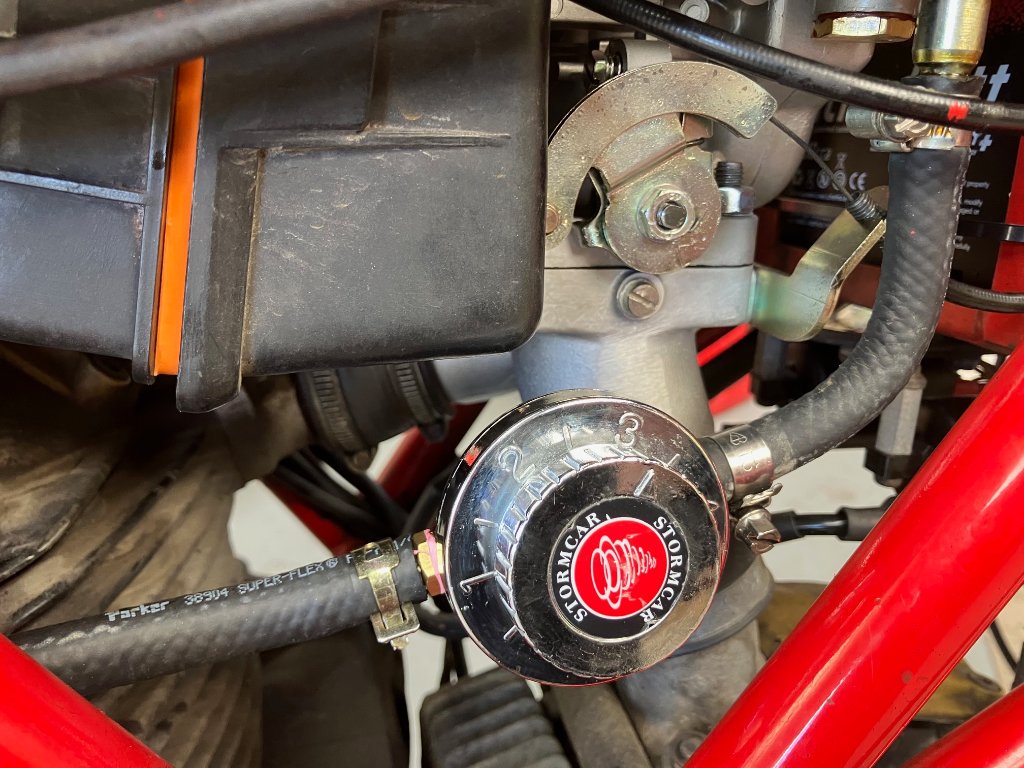

After doing some reading on this forum I decided to purchase an inline fuel pressure regulator to see if that would improve my running. I found a 1-5 PSI jobbie on AliExpress for not much and it has definitely helped. I have it set on 3 PSI but TBH it doesn't seem to change much if you adjust the knob in either direction. I want to check with a pressure gauge just what my actual fuel pressure is but it's definitely helped fitting this device. The bike is starting a lot quicker too.

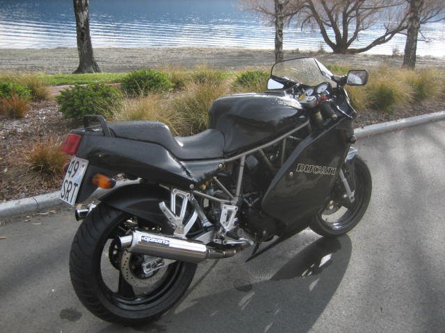

When I got my Paso I thought the brakes were pretty good , maybe not the strongest , Then I got the SS
and like way better and the plan was to get some on the Paso but then I got to thinkin that I thought the Paso brakes were great to start with so in the end I didnt bother .

Nice bikes the 750SS, I had a '93 model (aluminium swingarm, wet clutch) for about 10 years but its so many moons ago now I can't remember how good the brakes were. Given that I had traded up from a '77 Darmah they probably felt freakin awesome by comparison :lol:

"I ordered a double banjo bolt with bleed nipple attached (second pic) as I have found from experience this makes bleeding up a whole lot easier."
+100, really makes you life easier.

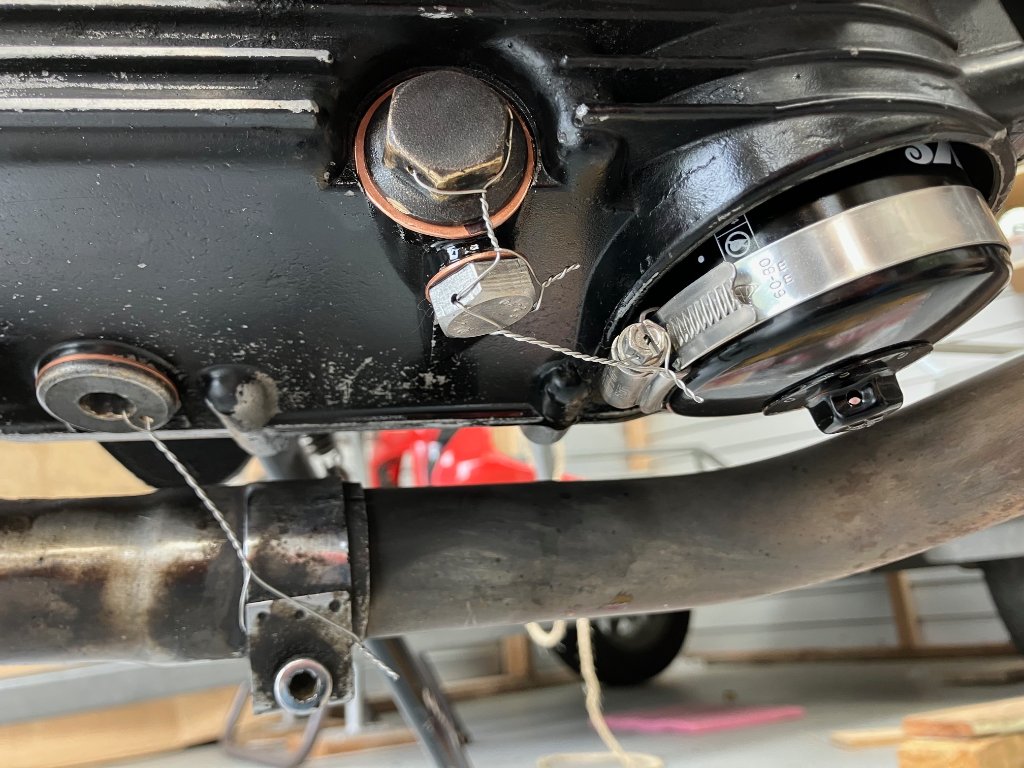

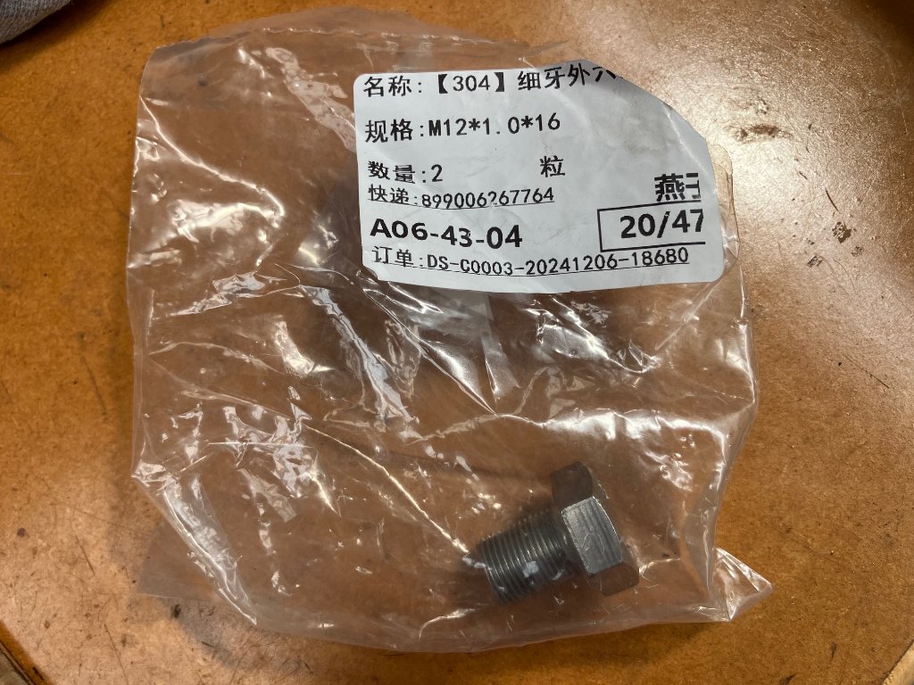

I managed to find a M12 x 1.0 pitch hex head drain plug bolt in stainless steel on ebay. I got two because they were cheap.
https://www.ebay.com.au/itm/27549945214 ... 6352740269
I drilled a hole in one of them for wiring off and put a copper washer under the head and job done.

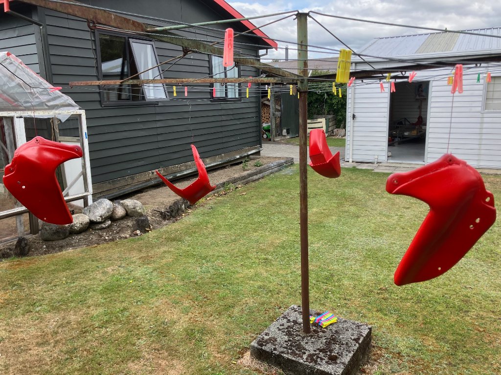

Painting

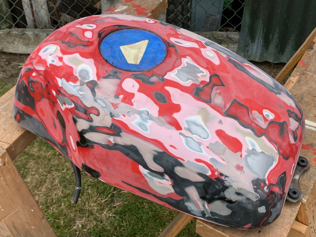

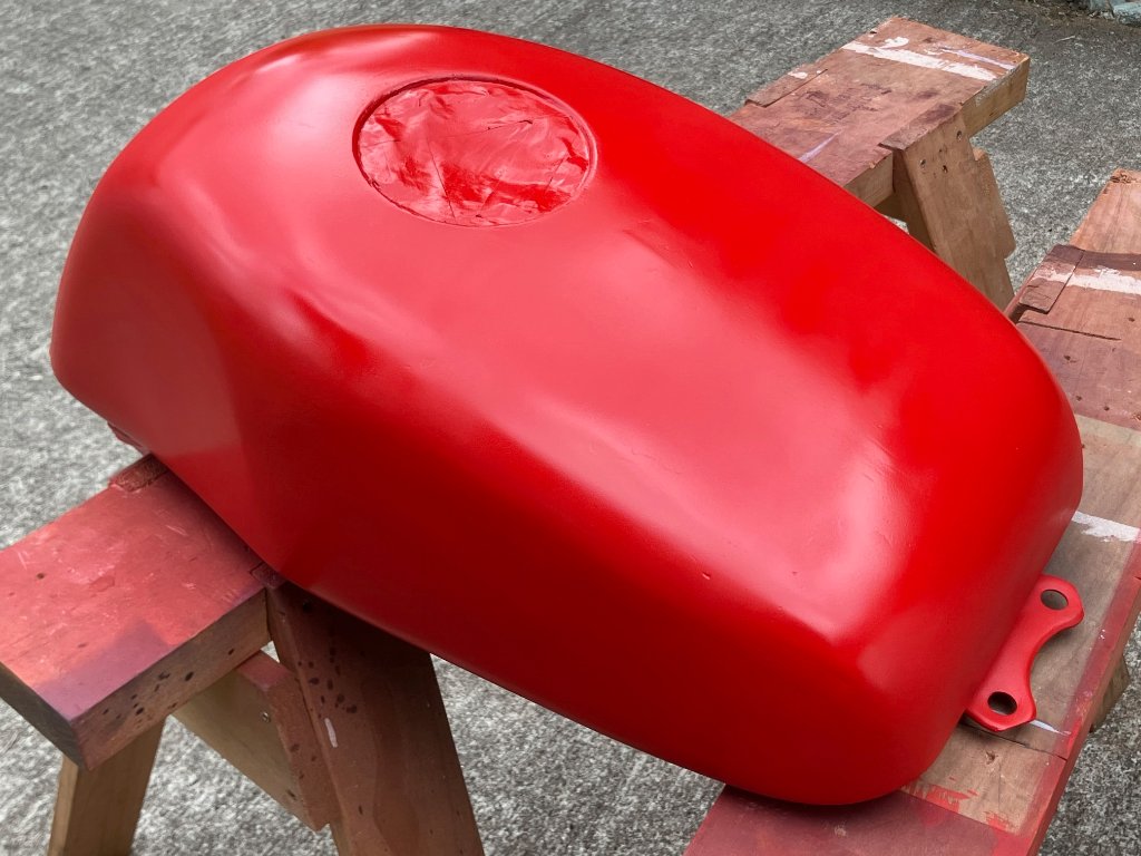

The tank was covered in a mixture of wrap and paint and took a bit of removing. It's been knocked about a bit and has had some rough repair work done in the past. I didnt get too carried away with my prep, just enough for my rattle can paint job to stick! I will get it professionally done in the future.

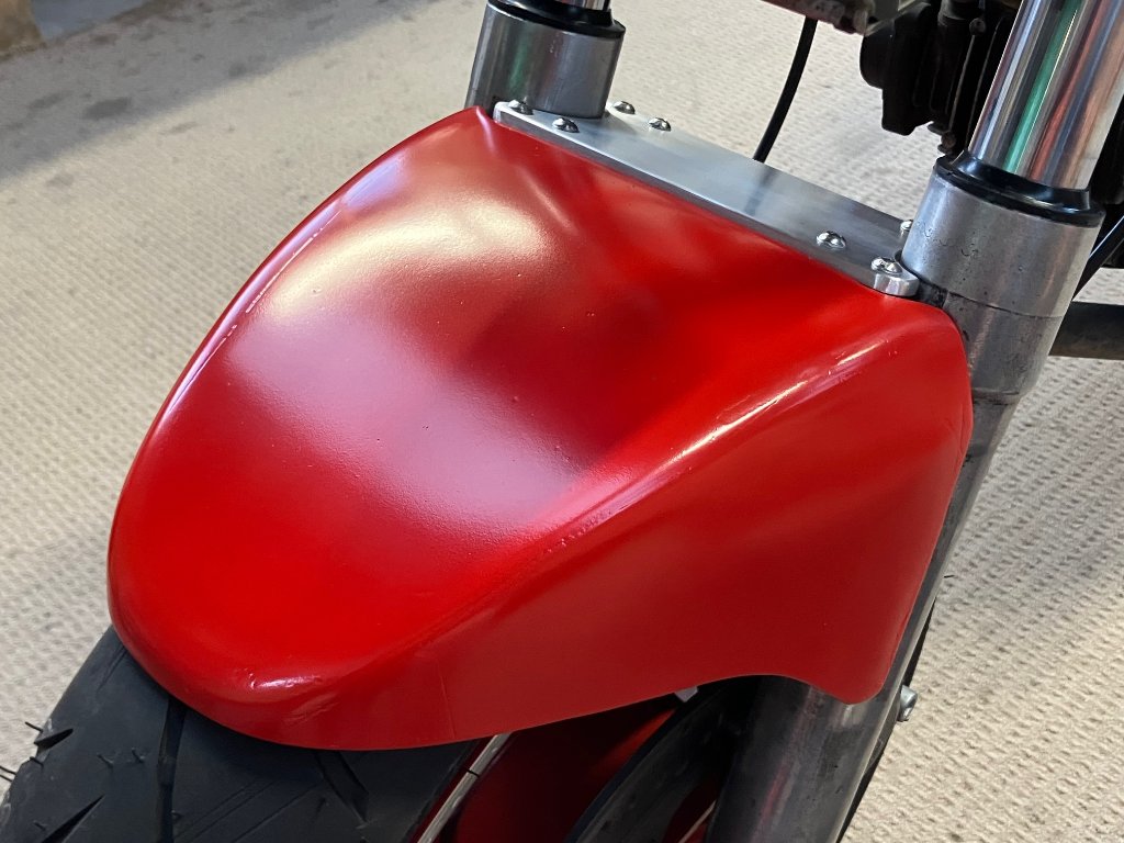

The fairing parts are in poor condition but the front guard came up alright:
