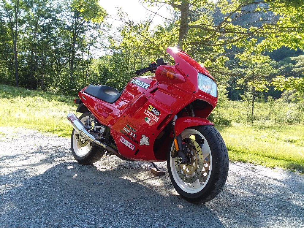

I was remiss in not updating my charging problem solution. all diagnostic work pointed to a faulty RR so I sent mine to rick's motorsports for testing. rick's tested the unit when it was received, and their tech called that day. my RR was faulty so I ordered a new unit, it was shipped that day and rec'd in 2 days. $20 testing fee was applied toward the cost of the new unit, free shipping to me, and it works perfectly. $125 total.
