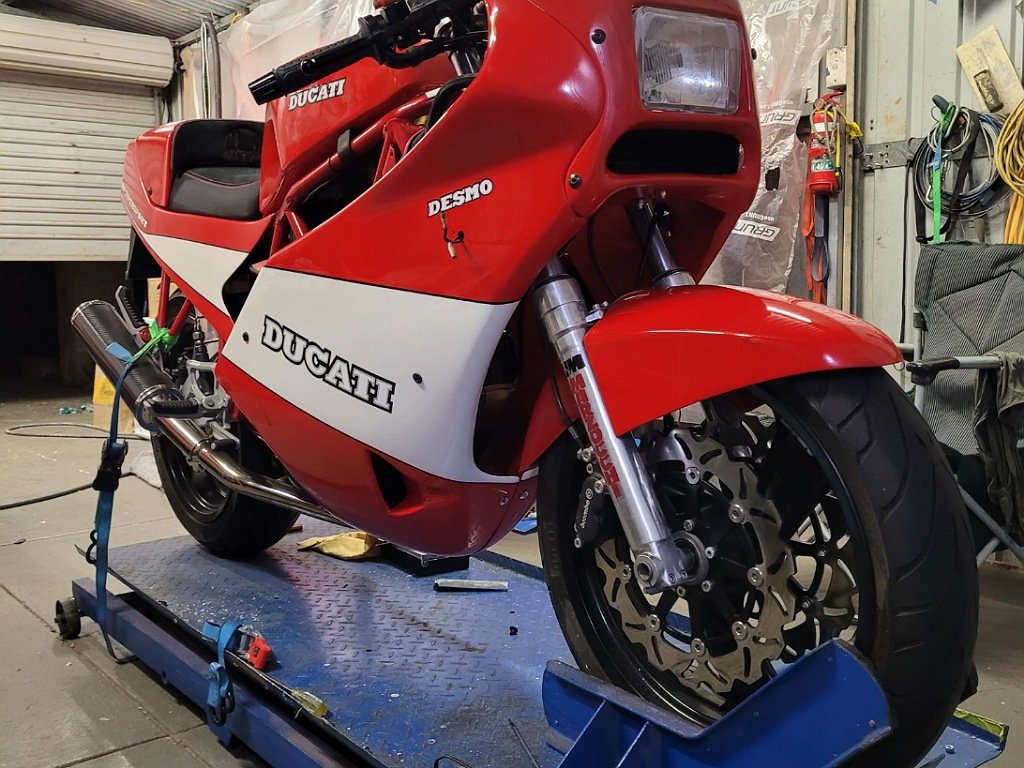

Some progress
HIGHWAY89
Posts: 637
Re: Oil leaks 89 900 ss
Post by HIGHWAY89 »
HIGHWAY89
Posts: 637
Post by HIGHWAY89 »
I went with the later model 900 ss mirrors, I think they might be more functional and look pretty right, swapped the fuel tank internals to the freshly painted tank as well.
HIGHWAY89
Posts: 637
Post by HIGHWAY89 »
I've also fitted some new black mouldings to the bottom edge of tank and front edge of the new mra screen.
HIGHWAY89
Posts: 637
Post by HIGHWAY89 »
I had to go with silver plated fixings on the fairings as I so far haven't been able to find any black anodised screws

HIGHWAY89 wrote: ↑Fri Feb 03, 2023 4:08 pm I went with the later model 900 ss mirrors, I think they might be more functional and look pretty right, swapped the fuel tank internals to the freshly painted tank as well. IMG_20230204_000422_(1024_x_768_pixel).jpg
@Highway - Looks brilliant, you've done a great job! Could I please ask what sealant or special gaskets you used to transfer the tank internals? I'm awaiting some parts and preparing the do the same thing renewing the pump and sender.
Thanks
HIGHWAY89
Posts: 637
Post by HIGHWAY89 »
Thanks for the positive feedback, as far as transferring bits to the new tank , I used a new black rubber flange seal under the fuel cap, original stainless screws as I couldn't locate and purchase new ones. A new crush washer under the tap post. The original green seal with the pump / sender attachment and I'm pretty sure that's all besides new fuel hose, I may have put a new o'ring on the fuel cap as well. I'll have a closer look at that later and check . I didn't use any sealants at all, not sure if you need to? I hope it doesn't weep around the filler cap area is my only concern, ill find that out only after I ride the old girl I guess. I hope this helps mate .
