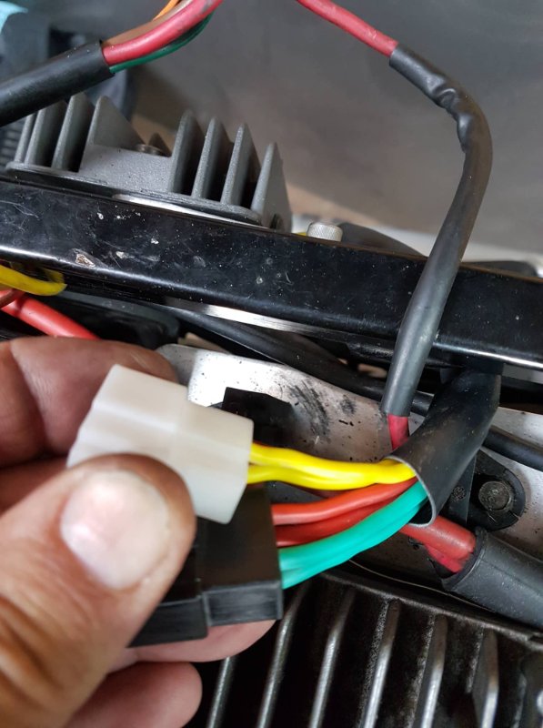

I have a replacement regulator which only has 2 x red wires, 2 x yellow and 2 x Green wires.

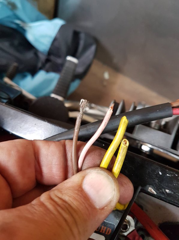

My bike has 2 x red, 2 x yellow, 1 x Brown and 1 x pink, I have looked through pages and pages of info on the regulator and cannot see any info on the brown or the pink wire. I know the yellows go together as do the reds and I believe the greens are both earth? It is the brown wire and pink wire which originally were in a rubber connector and plugged into the old regulator I have not a clue where they go. Any help would be greatly appreciated

You have 2 red and 2 yellow, a brown and a pink wire? That's interesting as those are the colours that can be found on the 907IE.
According to the wiring diagram the 906 would have 2 pink, a red, an orange and a red/black, a light blue and a brown wire.
Is there anything stamped on the regulator/rectifier, a model or number which could help identifying it? If not, please post a picture.

This is a photo of the wires on the bikes harness The new regulatorpaso750 wrote: ↑Tue Aug 16, 2022 9:02 am You have 2 red and 2 yellow, a brown and a pink wire? That's interesting as those are the colours that can be found on the 907IE.

I think that any modern reg will require a bit of wiring modification . Paso has a couple of extra wires , one for a voltage sensor ( which can cause excessive charge voltage when the wiring gets a bit tired ) My paso has a honda reg fitted .... not by me but its worked well so far .
I cant remember exactly how a modern reg is wired in but there has been plenty of discussion and tips on the subject , maybe do a search and look in the faq's but dont give up it aint that hard when you know how .

I use a shindengen fh012aa regulator, I have only connected the 2 pink from the generator and the red/black and the black wire to the battery. It has been running great for a year now. Down side is you will loose the charge dash light.

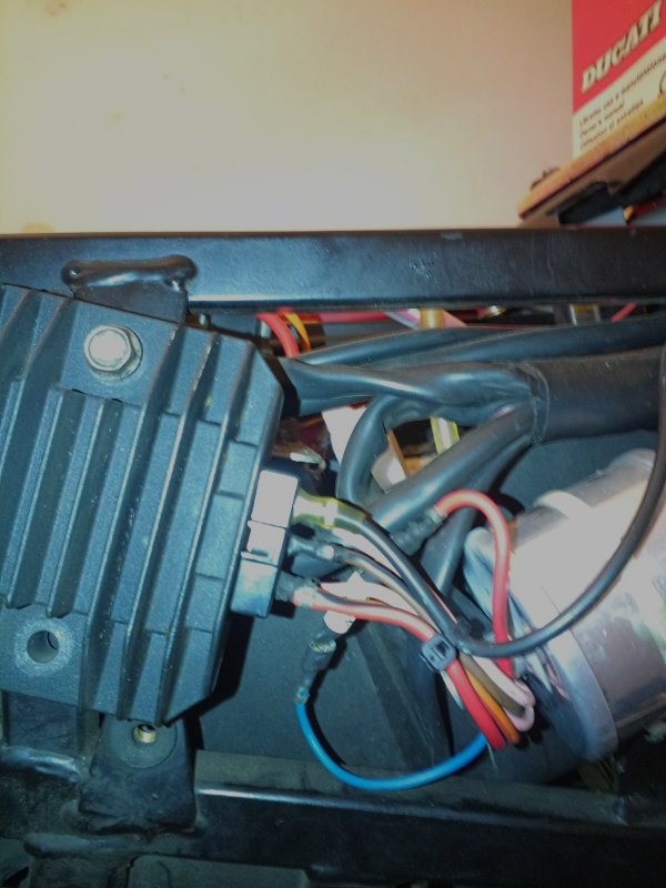

The Paso charge system is a funny one. The 2 pink wires are AC and must be rectified. The red wire from the 'alternator' is 12v and goes to the charge circuit. The 12v output from the rectifier goes to the coil feed. I can pull my Paso panels off and double check this but when I used the Energis rectifier it always gave trouble until I swapped for a Kawasaki unit. The igniton coils are hopeless inefficient and a good swap is for Aprilia with an impedance of 3.5 Ohm improving run characteristics and charge for the Paso.

I have a Kawasaki rectifier here and I'll explain the wiring connections. First, the red wire from the alternator is 12v and although this could be used for power I found this was heating the lead from the alternator (not good) so I've connected it to the blue from the instrument panel and this is now the charge light feed. The pink wires from the alternator are rectified. The red/black is battery charge, the brown/black is regulator output and this goes to the coil feed. Black wire is 0v earth.
The battery never overcharges and the electrolyte level rarely has to be topped up, unlike with the standard energis rectifier which needed this every other week. On top of that I've got a charge indicator, it works because the instrument light has a 12v feed and if the alternator is stopped the current will flow thru the windings back to earth (eventually). When the alternator is energised the red wire has a 12v output and opposes current flow from the blue wire - warning light goes out.
I note the subject Paso has 2 yellow, red, green wires. I am not familiar with this I advise you check the source of these wires before connecting anything at all.
