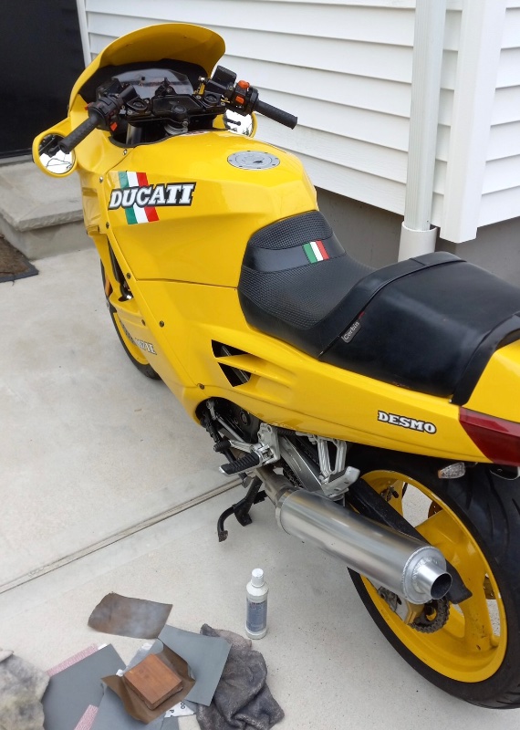

Post by Fvee3 »
1992 Ducati 907ie Yellow
2018 Yamaha Eluder GT Silver
