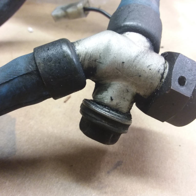

Not the best picture, hope it is what you need ...
Otherwise let us know why you need it

Hi Marco,
Here you have the actual oil temp. sensor (M10x1 mm. - similar thread to a Brembo banjo bolt).
A new one costs 16 euro.

The thermistor is the same as the Volkswagen Golf MkII
https://www.ebay.co.uk/itm/Fits-VW-Golf ... 4902.l9144
