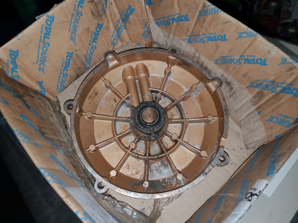

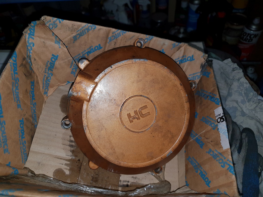

Wow , theres some nice covers right there, I'm waiting for a spare cover to turn up soon,my thoughts are to drill one of them. Is the powdercoat brake fluid resistant?i wreckon the polished units look sweet but actually on the bike i think i like the black.Letting some heat out sounds good, dust as well , considering doing myself on a drillpress or is that a tried and stupid idea?

Ok I will probably change track there and try to go for pc , and make a decision on the drilling, thanks

Having a little look at how to drill this, exact location and size and not really stuffing things up I don't think at this stage I will vent this , it's a bit more complicated than I originally thought
