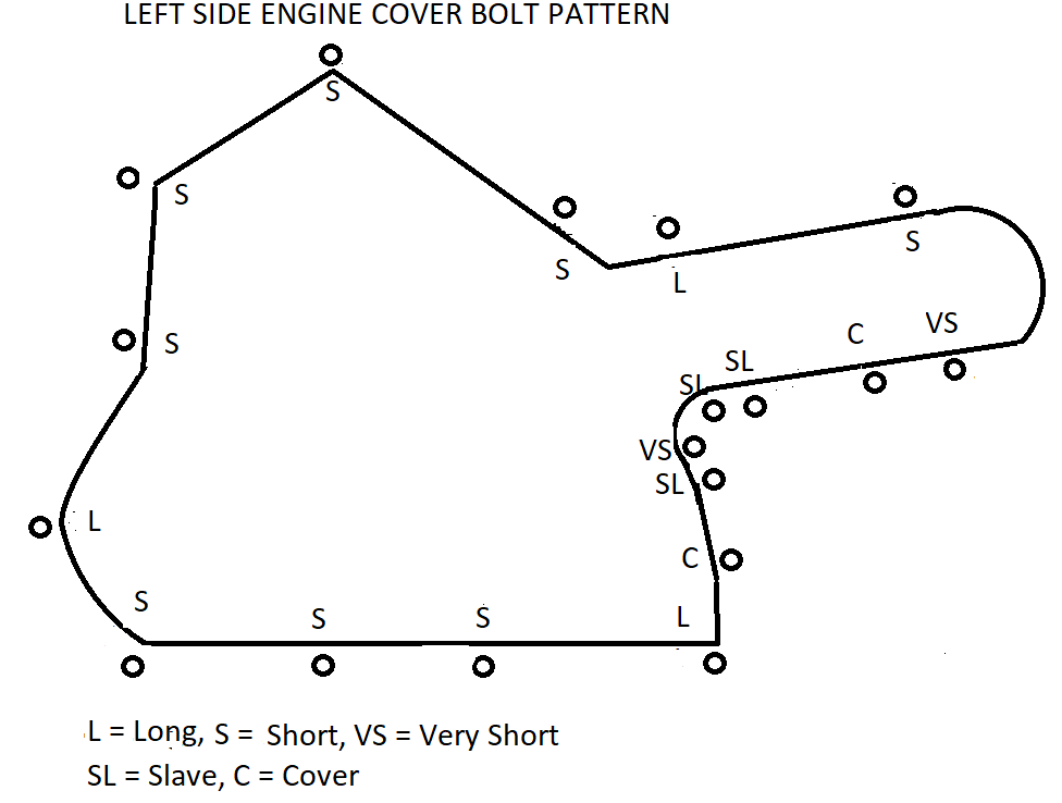

9. Remove the 13 cover bolts. Note there are 3 different lengths. Refer to bolt pattern image attached when reassembling. I didn't pay attention to the sprocket cover and clutch slave bolt lengths, setting them aside separately.
