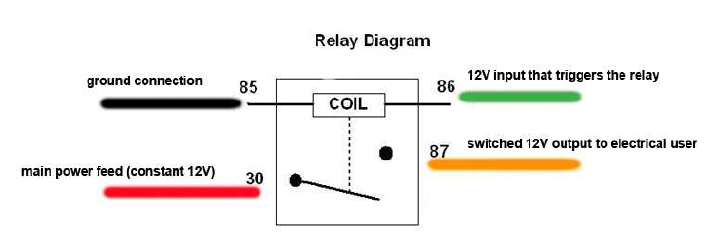

- The main diagram of the mod in the 907ie FAQ link shows the new relay, with pins not marked.
- relayunmarked.png (16.32 KiB) Viewed 203924 times

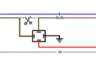

- The next page in the 907ie mod link has an image of a relay with conventional pin wiring. However, I don't think this is how the relay should be wired in this case.
- relayasshown.png (45.82 KiB) Viewed 203924 times

Re: 907ie wiring modification confusion
Great stuff, Nick. Can you confirm the wiring of the relay is as shown in the last image and not the one in the actual 907ie file?
Bill
91 907ie
Buckeye, AZ.
91 907ie
Buckeye, AZ.
nickta
- Posts: 318
Hi Bill.BillB01 wrote:Great stuff, Nick. Can you confirm the wiring of the relay is as shown in the last image and not the one in the actual 907ie file?
If it was me, I would connect the 12v to Pin 30 and have the switched 12v on Pin 87.
http://www.desmodemon.com/paso_project_5.html
It will work the way it is, but convention (if you can call it that) is to have 12v on the fixed of a switch. No idea why?
The middle picture is probably the way I would wire it up, with a 4 pin relay. The bottom pic has a 5 pin relay, which has one pin not connected? The top picture is missing pin numbers, but starting at the top and going clockwise, they would be: 87, 85, 30, 86.
One further thing. Always have a fuse in line with the 12v to pin 30 of the relay (assuming you connect it to pin 30). If there is a fault with the relay in the future, and you short 12v to ground, you will blow the fuse. No fuse and you may end up melting a lot of insulation and sparks and what not. Worst case is fire under the fuel tank, which could really ruin your day. It is possible to use the existing fuse holder under the seat, if you want to make it look pretty, but an inline fuse holder is cheap insurance. You just have to remember where you put it!
Hope this helps.
Cheers.
Nick.

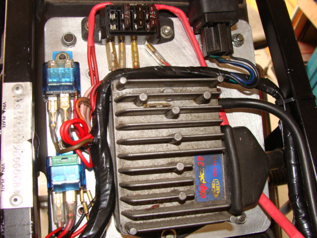

There is a minimum size , and most manufacturers hit that every time . I use 4mm for heavy stuff like headlights and coils and charging system , and 2.5mm for the rest . The idea being that the larger the cross sectional area of the conductor the less voltage drop .
I use one relay for the main relay but the second is for the coils and magic box ..... I have 2 more up front for the hi low beams ........probly a bit of over kill
- DSC01621.JPG (120.59 KiB) Viewed 203877 times

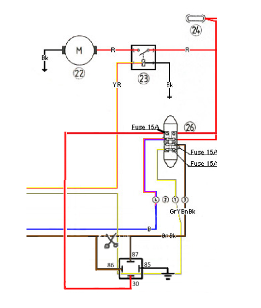

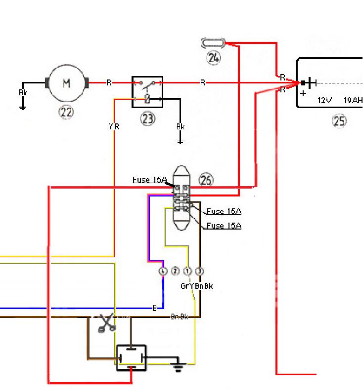

I'm finally getting around to doing this mod, 6 years later, after my 907 mysteriously lost all electrical power twice, for a brief period. I observed the battery was overcharging (15.5 V), and replaced the voltage regulator and the yellow wires and connectors that were badly burned, along with the now-bad battery. Testing the bike, all charging was good, but it lost all electrical power again. Wiggling the cover on the bottom of the ignition switch restored power. Further wiggling caused it to come and go. So, I need to disassemble and check the switch contacts and DO THE WIRING MOD.nickta wrote: ↑Sat Nov 09, 2019 5:41 am One further thing. Always have a fuse in line with the 12v to pin 30 of the relay (assuming you connect it to pin 30). If there is a fault with the relay in the future, and you short 12v to ground, you will blow the fuse. No fuse and you may end up melting a lot of insulation and sparks and what not. Worst case is fire under the fuel tank, which could really ruin your day. It is possible to use the existing fuse holder under the seat, if you want to make it look pretty, but an inline fuse holder is cheap insurance. You just have to remember where you put it!![]()
Hope this helps.
Cheers.
Nick.
Based on Nick's comment (quoted above) about using the fuse block, which has an unused 15-amp fuse with bare connectors ready to accept some wires, I altered the existing wiring mod image to reflect this idea. Note that the only difference from the stock wiring, other than cutting the brown/black wire to insert the relay, is the red wire routed from the relay to the fuse block and from there to the battery.
This shows in concept what Nick mentioned. I will cut the brown/black ignition switch wire close to the fuse block to install the relay.
Thanks to Nick for this simple method. The original wiring mod diagram did not lead me to this simple way of doing the mod.
