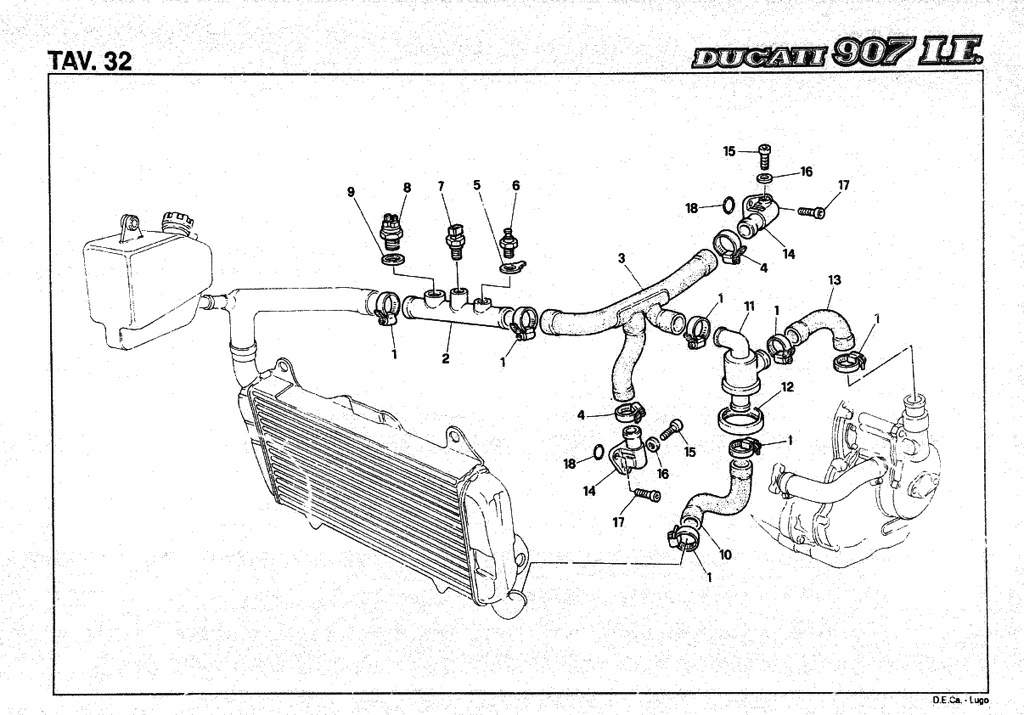

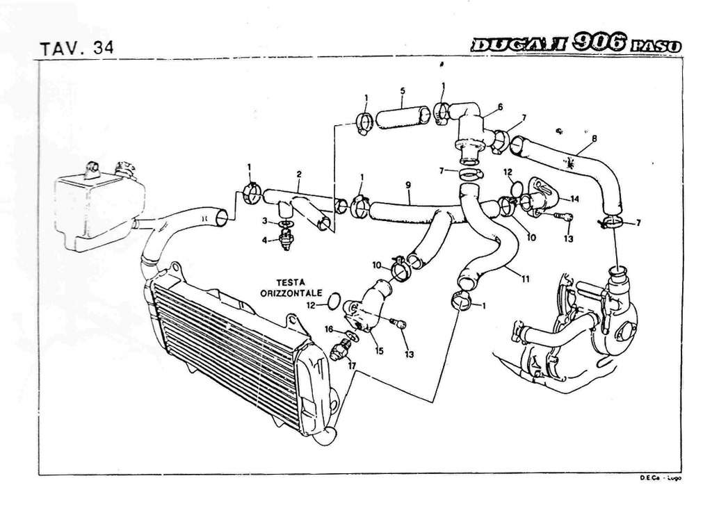

Looking at the coolant hoses they aren't too bad but I would really like to put new ones on... but can't find anyone who will supply direct replacements for a 906.. However, I can find replacements for the 907ie
So, the big question is.... are the coolant hoses for the 907ie and the 906 the same???
..and if not, where could I find some (or get them made) ????

No, the coolant hoses of 906 and 907IE are not the same. Two or three small ones are but the main ones are not. Maybe you can try contacting Bruce from https://racebikebitzusa.com/ . He's the guy who helped getting the 907IE hose set made. As so few 906s were built I'm not sure if Samco would have any interest in making a set for the 906 but it's worthwile asking.
Finding a source for an original set will be almost impossible. Maybe if you search for the part numbers of every single tube over (a longer) time you will be able to get a full set together.

If anyone is interested in hose No.9 from the diagram above, I’ve had one made at my expense out of silicone from,”Leyland hoses” which I’m going to collect in a few days.
