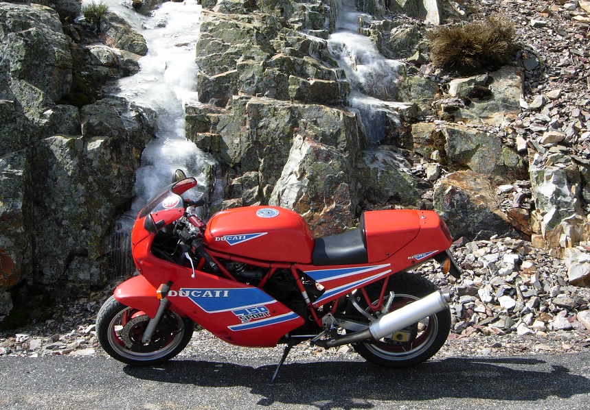

I want to get back on the road with my ducati 750 Sport, which I had in a corner of my garage.
I have come back strongly, and I bought a 900 Supersport 90 in England.
As an amateur mechanic, and with his help I think I can get ahead, with the return to the road.

As for the headlight the 750S and the 900SS share the same unit. Try to ask Rudy, maybe he has one. You find numerous of his posts in the classifieds section.
Btw. that is a nice and clean looking 900SS
