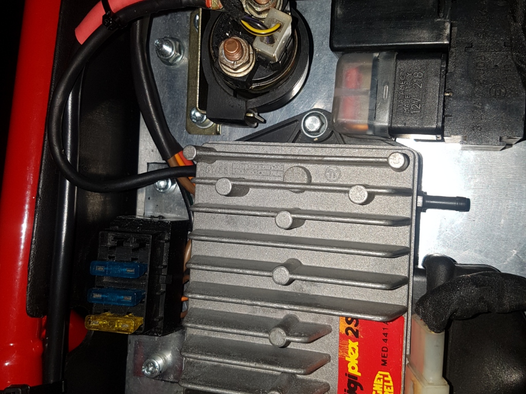

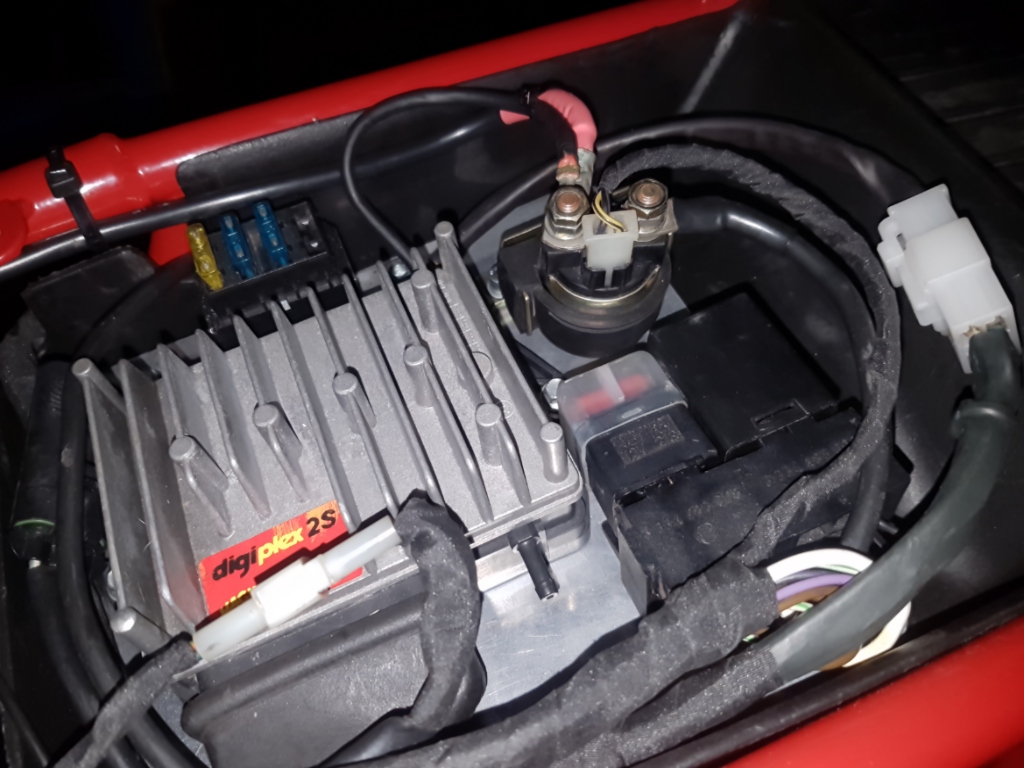

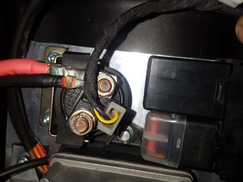

Got some confusion with befitting my main harness, firstly with solenoid and starter motor , should I have a cable between the two , also the small black single cable coming from digiplex unit is just a earth to frame, any help appreciated

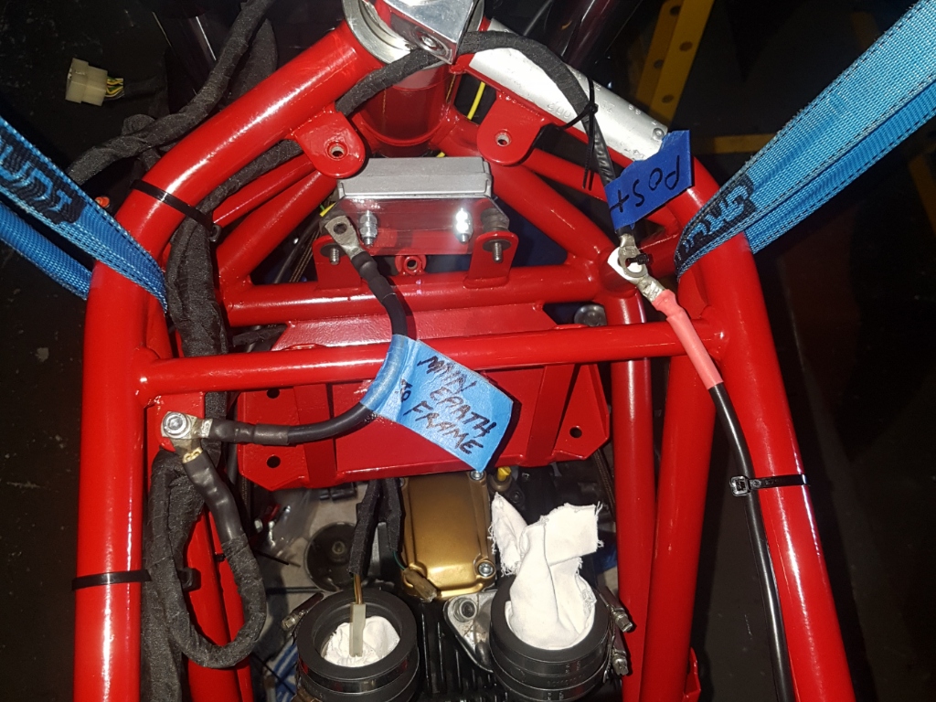

I think it's right now , in the 2nd pic I'm about to send does the earth from digiplex carry onto engine as I have shown , 1st pic is solenoid wiring now

Or does it just stop at the frame

Positive from battery - solenoid - starter.

Thanks Gert that all makes sense , in this next pic does the battery setup look right , electrical obviously not a strong point of mine, the next biggie for me will be connecting the regulator correctly , your help much appreciated

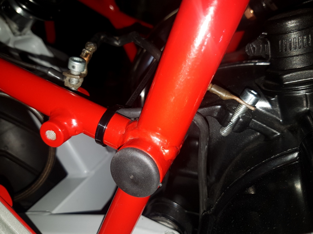

The earth strap going to the rear of the engine looks all wrong but was like that when I got the bike , the thread on the case looks to be for an adjustable cable ?

I know it's painful on a new bike but the paint should be removed where the ground cables are installed.

HIGHWAY89 wrote:The earth strap going to the rear of the engine looks all wrong but was like that when I got the bike , the thread on the case looks to be for an adjustable cable ?
Hi,
your set up is the way Ducati did it.
The M8 thread is for engine earth, no other purpose
So everything the right way.
But it turned out, that going that original way with two short earth cables to the frame (one from the battery and the back one) was not ideal.
It could build up top much resistance especially for the starting circuit.
So having a longer earth cable direct from the battery - to the thread on the case makes a difference.
I think Ducati made it that way with their later models.

Thanks Matt I will make a new cable ( same size?) Thanks Paso 750 I'm definitely holding off on the vandalism for the earths

Yes, same size cable at least.
On mine I have a Motolectric cable kit.
Maybe you like to read through their blog on that topic:
