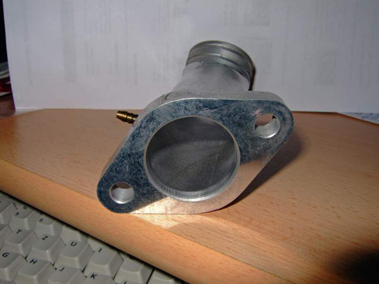

Middle of inlet manifold, that`s what Ducati did themselves.[quote][/quote]
Brutus
Posts: 257
Location: The Netherlands
Re: Connection vacuum for pulse fuel pump
Post by Brutus »
Hi Frank, I´ve installed it on the manifold:
http://forums.ducatipaso.org/viewtopic. ... t=digiplex
