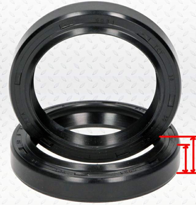

I understand all the other figures but could you explain 7,5/10mm. If 7.5mm is the height what is the 10? Is that the thicker alternative that's hard to fit?paso750 wrote:Make sure to get oil seals in the size 41,7 x 55 x 7,5/10mm. The 7.5mm is the height
Re: 906 fork oil change
the 7.5mm is the height of the shoulder, the 10mm is the total height including the inner lip.
The overall height is not that relevant. The shoulder height is what determines if the lock ring which is installed above the oil seal fits in its groove or not.
