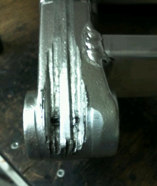

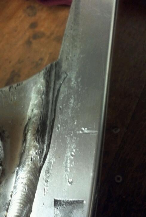

The PO probably never ajusted the chain tension. The chain has chewed through the swingarm on the bottom side, all the way to the rollers and ground out a weld on the top side. Anyone got a good swingarm going?

Re: removing swingarm
looks like this;
- 907 swing2.jpg (36.07 KiB) Viewed 15383 times
- 907 swingarm1.jpg (30.14 KiB) Viewed 15383 times

Mine was similar , just not ground right thru to the bearing .I think the swing arm in my pic was the one I sent to Fraser ( which was dumb coz its better than the one on my Paso
) I just made a new chain slider that went right round the pivot , just a 30mm wide strip of nylon strap 5mm thick , heated up and bent round the swing arm and pop rivoted on ................then I found some new Ducati chain sliders.
Beats me , if you run the chain anything like slack enough to do such damage the gear changes are real bad and that alone would make me want to tension the chain properly ...............but then I have heard of people blissfully riding round with their sprocket bolts cutting their swing arm in half
