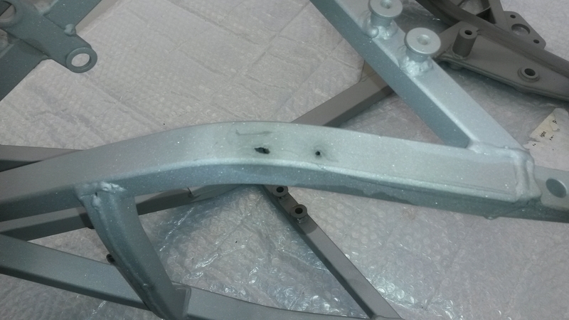

I got a call from my powder coater telling me that after they sandblasted the frame there were 2 holes .... see picture.
Looks like corrosion, bur for me at a very strange (unexpected) place, left downtube from the headstock
Ever seen something like this?
Got it repaired but am a little surprised/disappointed about the steel quality of the frame.
I always want to find the roothcause of issues and this is a strange one for me ...

Hej Frank, could it be that the holes were drilled at some point and age / climate did the rest..?
Re: no topics?
Hi Léon,
No, before sandblasting there was nothing to see.
Was just rotting from the inside but can't see how moisture could come in .....
Always thought that a steel frame was bullit-proof, well ..... not anymore.
Assumed the 25Cr4Mo was much more corrosion resistant .... Italians!

Nah! They sent all the dodgy Paso's ( apart from nnnnnnormans
) to Belgium

Mc Tool, if I would follow your advice, my frame would corrode even more ...
But seriously, ever seen something similar (because it really bothers me) ?

I have seen the odd bike frame with this sort of internal corrosion , but mostly trail bikes , and some are well known for it but I have not heard of it on a Paso before . Mind you older Italian vehicles are bad for it , Lancia and Fiat are just another work for rust bucket
Re: no topics?
actually it seems to be a fairly common occurrence. I have supplied more than one section of my spare frame to be welded in place of some corroded ones. From what I can tell there appears to be some frames where the sand was not cleaned out of the tubes before welding the frames up. I can only guess this sand is setting up some sort of electrical process causing the corrosion from the inside out jm2c

Very poor quality of steel. I don't think this could be dangerous, but it's likely to be some kind of crap or hole, hidden by painting. Your frame has ridden for 28 years since now with no matter. Repairing the holes should be enough.
have a nice ride, Nicola

Frank.61 wrote:Well, in that case .....t after they sandblasted the frame there were 2 holes .... see picture.
Looks like corrosion, bur for me at a very strange (unexpected) place ........ Frank
.... once upon a time , an old ducati seller said to me about new generations ( paso those days) difference .... ' frame is not same any more ' .....!
