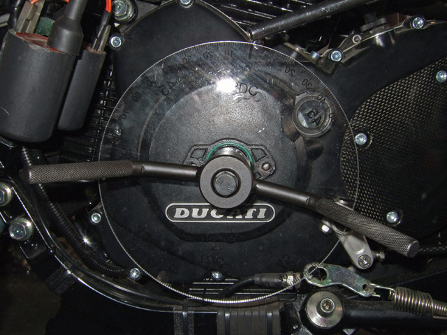

Replacing the belts is straight forward. Rotate the engine until the marks on the cam pulleys and the driving (bottom) pulley align with the marks on the engine.
I added my own marks on pulleys and belts so I could copy them on the new belts and be 100% sure the new belts would sit exactly as the old ones without skipping one tooth by mistake. If the belts are going to be reinstalled also mark the cylinder and the running direction.
I bought myself a cheap tool to lock the cam pulley of the rear cylinder. What some don`t know (although it should be obvious) is that all marks that were aligned before mean the front piston is in TDC. The rear piston of course is not. In fact a valve rocker spring is putting pressure on the camshaft rotating it counterclockwise a bit as soon as the belt is removed. (hence the tool which is just stuck with double sided tape) Of course one can just be careful and make sure the pulley mark is aligned again when the belt is installed.

Hail to the inventor of transparent timing discs with black printing :banghead:
