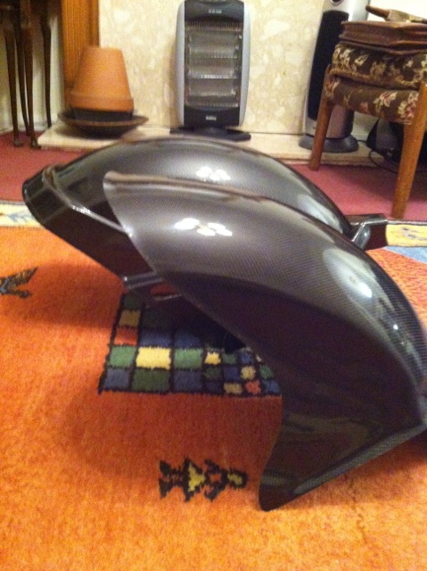

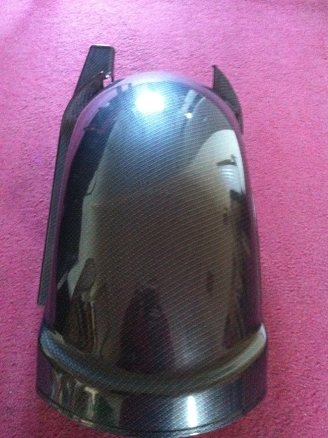

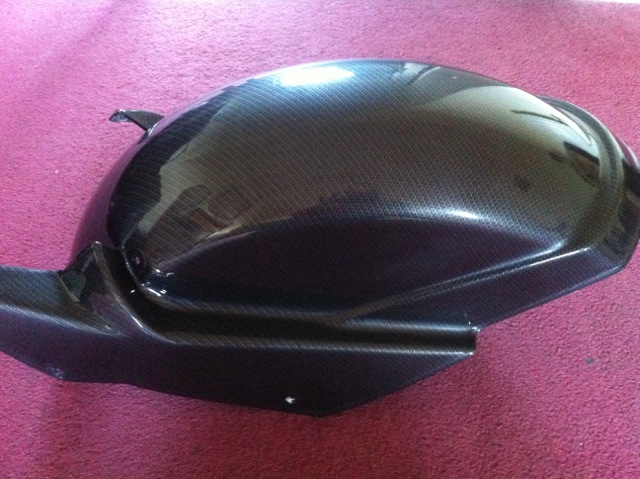

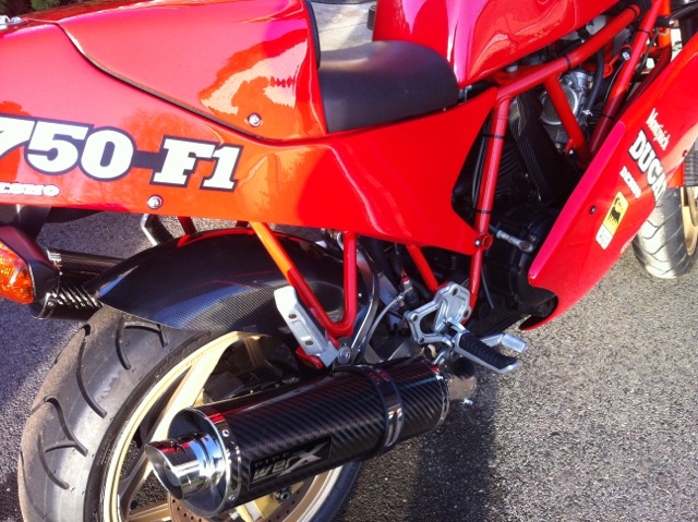

Hi All, You may remember me asking if anyone knew if anyone made a carbon fiber rear hugger for a 750 Sport. Well after no luck it was suggested I tried wrapping it with the 3m Carbon look alike wrap. Although the actual wrap looked very realistic it failed to drape well around the curves so I gave up on that one. It was then suggested that I got it carbon dipped via Hydrographics. This has come out very well and has turned the pretty ugly large dull standard hugger into something a little more appealing...at least to me anyway!
So I thought I would attach a couple of pictures of it for any of you who may be interested.
I also may now have found a source for a real carbon one so I will advise details on here if that proves successful.

Wow, that is amazing.
Not only that they would do a one off, but also that they got that to stick to polypropylene.

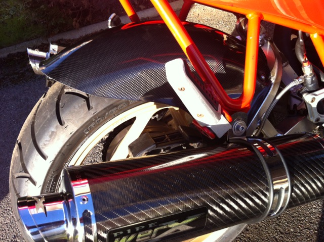

I also now have a real carbon Hugger. They are made by Diopa in Germany. basically it's a shorter version on the standard one above using the same locating holes as the 87-90 version sport. They list quite a few other things but this is the only one they do in Carbon. They are not quick at replying and struggle a bit with English! But quality was good, you have to drill the holes yourself but they are marked from the moulding process. Here's the link:-

Carbon Hugger on Bike

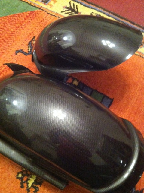

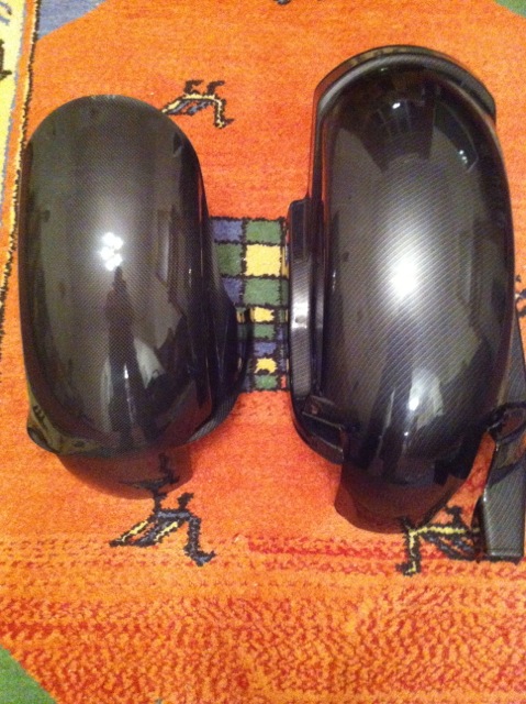

More Pics, with the original (now Hydro carbon coated) hugger next to it. The real carbon one doesn't cover the chain like the original.

that looks like a standard SS hugger with the mounting tabs removed & shortened a bit

Similar but made for the sport. This is the listing:-
