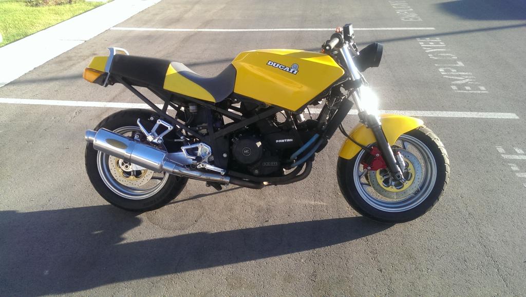

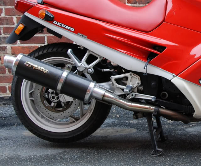

But that`s me. I personally find it more difficult to start off with something already modifyed (in this case a Mikuni with a pilot jet from a 750, the needle jet from a 900 and an unknown aftermarket needle). Of course you would need a leaner jetting for the altitude you`re living at but on the other side you don`t have an airbox, but you`re using UNI pod filters and have (what seems to be) a Two Brothers exhaust which will make carburation leaner. The effect of the altitude could be equalized by filters and exhaust or maybe their effect is stronger than the thin air.

I am not sure on the exhaust brand, I have looked at it but can't remember.. it seems to be running good, still not idling as well as I would like.. I still have symptoms of a vacuum leak but there is none..
