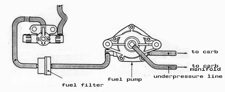

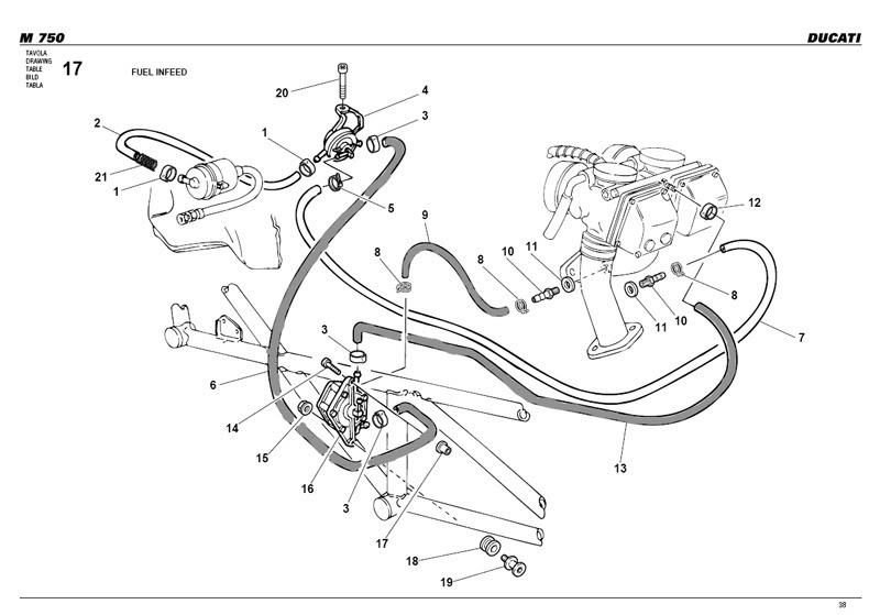

Re: alternative fuel pump
this is the Monster fuel pump
a picture from Lanes bike
the Yamaha TDM/TRX fuel pump which I prefer as it`s easier to mount and has all connections on one side
a pic from my bike
Monster pump left, Yamaha pump right. Both are made by Mikuni.
The advantage compared to the original fuel pump is that it doesn`t draw any power and there`s no need of a fuel pressure regulator.
I`ve bought 5 used fuel pumps in the past. All are still in use and working. (Two in Australia, one in NZ and two in Germany). There`s not much that can break down on a vacuum pump. It´s just the membrane and if the pump is installed properly with a fuel filter before it there`s nothing to worry about.
I personally don`t have any concerns buying a used one.

So how do these vacuum pumps work? Where is the negative pressure draw coming from? I might have to try this. Did you just make a bracket and attach the pump to your frame? Ps i have the 750 Sport.
- ducinthebay
- Posts: 1323
- Location: SF Bay Area
The vacuum line is attached to the intake manifold. There may be a brass nipple threaded in on both of them. They may be tied together with a T, and run back to the Digiplex for vacuum advance. Add another T into the line, and run it to the vacuum pump. The pulses of the negative pressure activates the diaphragm to move back and forth, and there are two one way valves to make it a pump. Mount the vacuum pump where ever you can. Plenty of room on the Sport.
