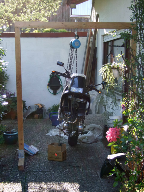

that`s not bad :)
I was using this in the past which I originally had made for pulling engine and tranny from my old Alfa. Unfortunately it wouldn`t fit inside the garage :mrgreen:
