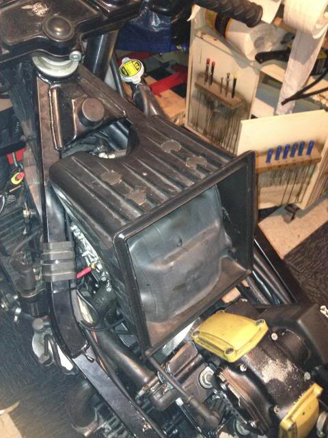

So I've been running with Mikuni CV carbs on my 906 for a while with a serviceable conversion of the Paso air box. The bottom was cut out and a flexible rubber mat glued to the air box with a couple of holes cut for a tight fit around the carb mouths. While that worked, it was only ever intended to be an interim fix...... that was 2 years ago!

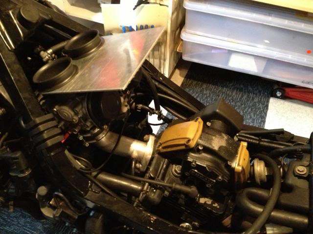

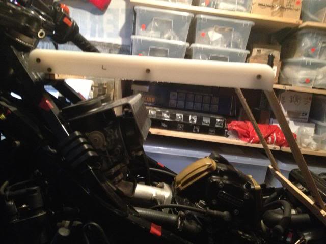

So finally I built up the energy to make a proper version that used the OEM rubber intakes for the Mikuni carbs as per the 400/600/750/900 SS family.

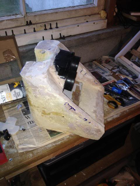

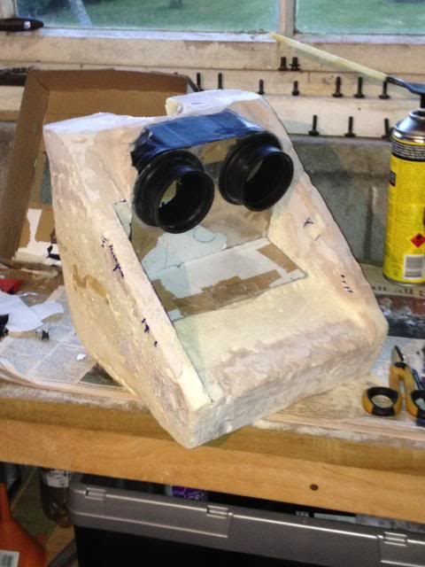

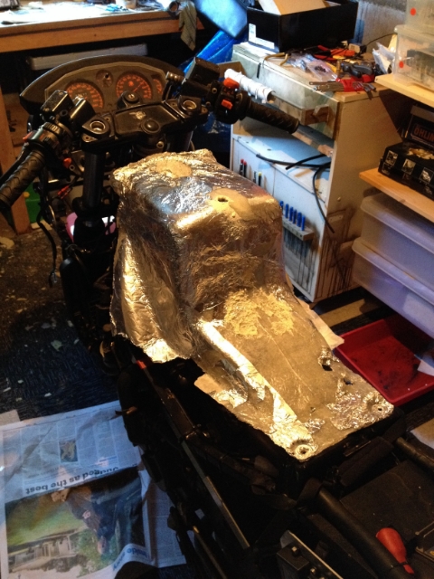

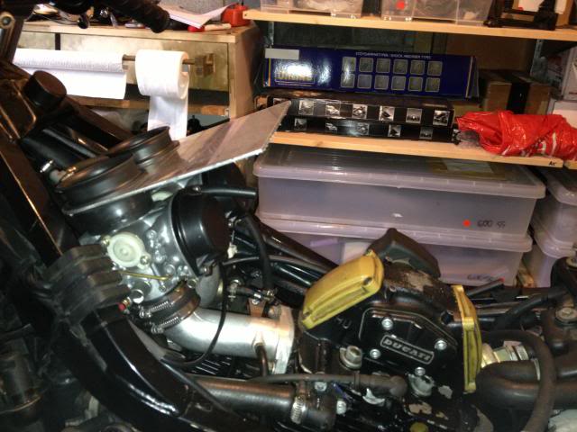

Made an aluminium plate to located the carb intake holes, and bent it to clear the carbs.
Made a fibreglass mould of the bottom of the tank, locating on the rear bolt holes and front rubber stop.

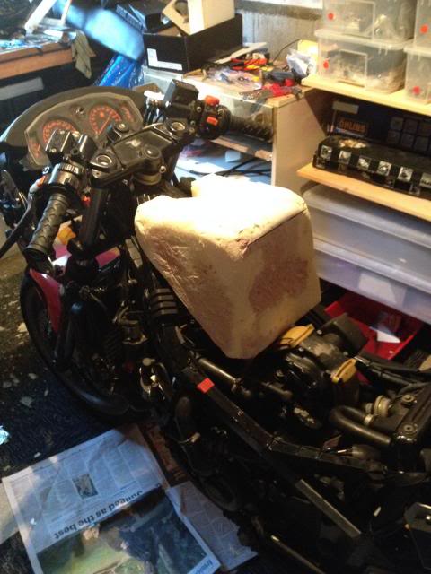

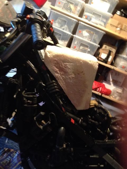

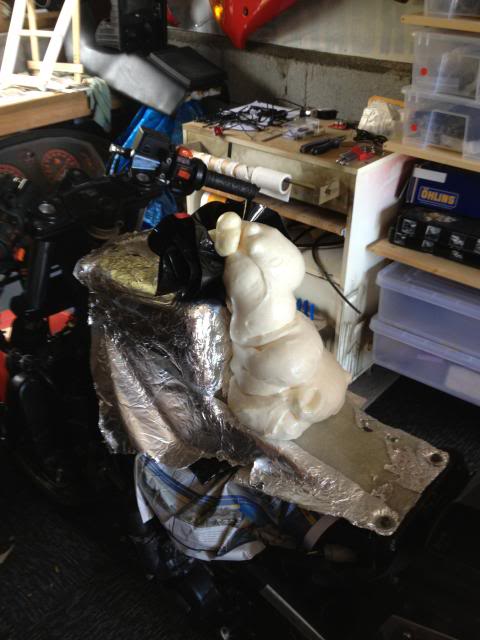

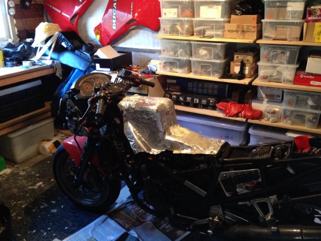

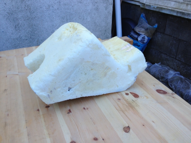

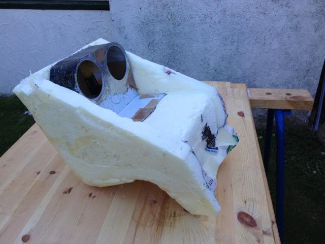

Made a cardboard box to cover the carb intakes, covered the bike and carb box with newspaper and used expanding foam injected through a hole in the top of the fibreglass tank template to cast a copy of the void space.....well the first attempt I forgot to plug the hole after injecting the foam.......!
Eventually I got a foam piece that was worth working on....
Next, sanding and using the foam plug to make up a mould and finally the fibreglass or carbon fibre airbox.......

Good points. I'm planning on sanding the foam plug down quite a bit as you suggest to make sure the tank fits well with allowance for the next layer. I've used some epoxy filler in places already to fill parts of the foam plug where the foam didn't set or expand into.
Once I've got the plug right, I'll wrap it in fibreglass, drill some locating holes, then cut the end off to start on forming a lip for the air filter to locate in. Then I'll cut it all open in half as you suggest - unless I can get the plug out some other way. This shell will actually be the mould/s rather than the final airbox. I'll make the air box up in two halves using these mould/s, then use the locating holes as the means to align the two halves for joining. Or so goes the theory...

I wouldn´t do that unless you manage to do it like in the 907ie airbox, chop off the top part of the airbox and place the filter there. the snorkels and the shape of the airbox lid serve the purpose to direct the airstream from the front to the airfilter on the rear. If you remove the rear lid and snorkels the air streaming by may cause an underpressure even reducing the amount of air that gets to the carb which performancewise would be counterproductive. Imho it would ruin all the effort put in building an airbox.

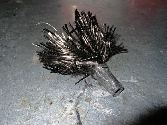

That´s easy. Find a metal tube that has the inner diameter of the original hose connector. Wax that and wrap it with a sheet of soaked glasfibre mat. Do not apply resin to the complete mat but only half or 2/3. Later remove it and pull the strands of the parts you left untreated apart. (This will take a woven fabric of course). Make a hole in your new airbox, insert the new part from the inside and laminate it on

You were lucky btw with the foam you used. The foam I used was a two component foam specially for moulds which came in different grades of porousness. When that was used up I used insulating foam which I regretted for a long time as that was some terribly sticky shit that also didn`t harden through completely in some spots making sanding it a miserable job. It all ended in some curses and scratching it all of.
