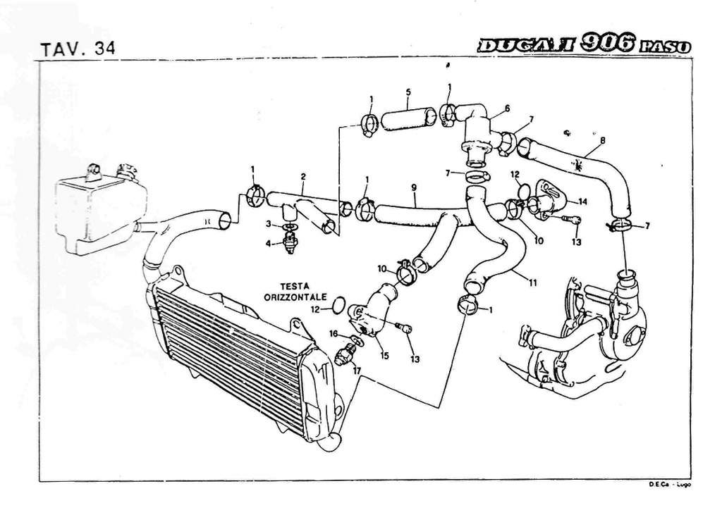

Also could someone who has both a 907 and a 906 verify whether the hoses are common or even if the 907 hoses would be a good alternate fit for the 907.

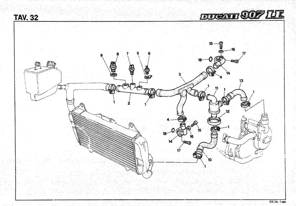

Andy, I`ve compared the part numbers
80010091A hose to radiator & expansion tank
80010161A hose to expansion tank neck
80010131A vertical cylinder water inlet sleeve
80010141A horizontal cylinder water inlet sleeve
are the same on 906 & 907ie. The rest is different

I guess now what I'm wondering is if a set for the 907 provides an alternative fit for the 906 as the only thing driving the difference appears to be the metal tube in the middle that carrier the temp sensor.
Higgy as an owner of both and "engineering capable" your opinion here would be most helpful

also 906 Horizontal aluminium water fitting has a different oulet angleDuc750 wrote:
