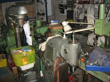

- machine shop in progress
- 120423 overview work shop web-size.jpg (31.98 KiB) Viewed 22970 times
