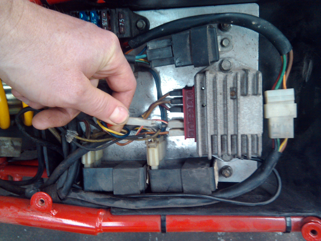

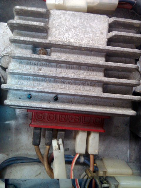

A new issue had arisen and it seems the bike needs a new regulator rectifier. So my mechanic tells me anyway.... I'm not at all mechanically inclined. I'm hoping someone can tell me which is the correct one! I have trawled through the posts on this and other forums without being able to arrive at my own sound conclusion.
The choices I've found:
http://www.regulatorrectifier.com/catal ... 2ac008b7c2
http://www.bevelheaven.com/stuff-for-sa ... trical.htm (just over 1/2 way down)
http://www.electrexworld.co.uk/cgi-bin/ ... RR51#aRR51
Attached pics are of the current (no pun) set up:

Looks like all the options you found were Electrex, or Electrosport. (same company)
http://www.electrosport.com/street-bike ... rectifiers
All work good, and are reasonably priced.
You should also add a ground to the chassis of the rectifier just to be sure.

I've shown all this to my mechanic, he says this one is the same as the current (no pun) unit: https://www.shop.bevelheaven.com/detail.aspx?ID=1360 (3 phase?)
Maybe my 750 has the electrics from an older pantah or something? That would explain the older coils you pointed out earlier in this thread.
- ducinthebay
- Posts: 1323
- Location: SF Bay Area
Re: Tell me about my 750 Sport, please
That one for sale from Bevel Heaven would be single phase. 3 phase didn't hit until the 916. Even the first year ST was still a single phase. All single phase rectifier/regulators will fit, you just need to connect the wires. Since you have the spade connectors, then it is indeed simpler to replace with one that looks just like it. The others would work, but you would then need to cut and splice wires.
If I had the choice and were at a point where I needed a new reg/rect I definetely wouldn`t take an original one. Not only does it cost twice as much as aftermarket ones but also the quality is not as good. The old original parts are infamous for their failures and I had 2 brand new ones that were not ok (too high output).
Of course aftermarket parts will require to modify the wiring but that`s an easy thing to so and definetely worthwile.
jm2c
jm2c

Thanks for the replies.
I'm a little confused about the third wire to the stator and where that joins up to on the aftermarket reg / rec unit. I'll take some pics today if I get the chance.
EDIT: Question answered by searching forums
The two yellows get joined into one.
the electrosport comes with instructions for both 2 wire and 3 wire stators
You can download the pdf from the electrosport website
