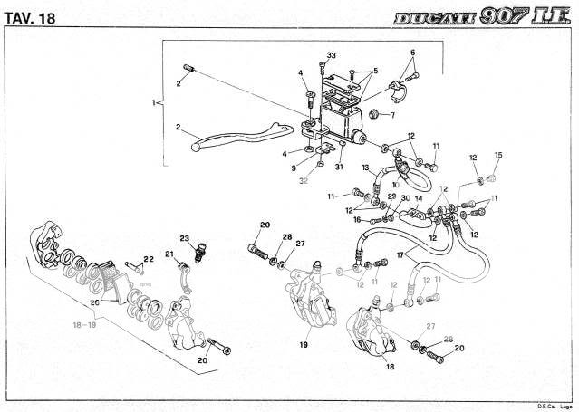

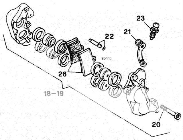

The original OEM pads come with a metal wire "spring" that keeps tension against the retaining pins to help keep out the rattling. Most after market brands don't have this wire spring. See the picture below.

I can`t se the spring in above expl views,
but usually there is one under 22 on black & gold 4piston Brembos.
Lies on top of pads.

In my drawing above, to the left of the word spring, the gray line is the "spring" that I was talking about. Below are some pictures I took of my 1992 907 and some old OEM ducati pads with the spring. The other pictures above of the caliper looks like a later or newer caliper than I have. I remember seeing those calipers on 900ss models.

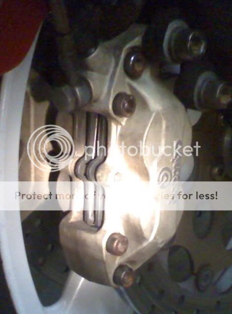

The rattle spring is visioned in Gerhards pic above:
It is the purple colured thingy keeping the pads in place, hold in place by the pin in center of caliper.
